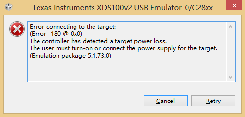

The controller has detected a target power loss.
Other Parts Discussed in Thread: TMS320F28069, TMS320C6657
Error connecting to the target:
(Error -180 @ 0x0)
The user must turn-on or connect the power supply for the target.
(Emulation package 5.1.73.0)

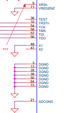

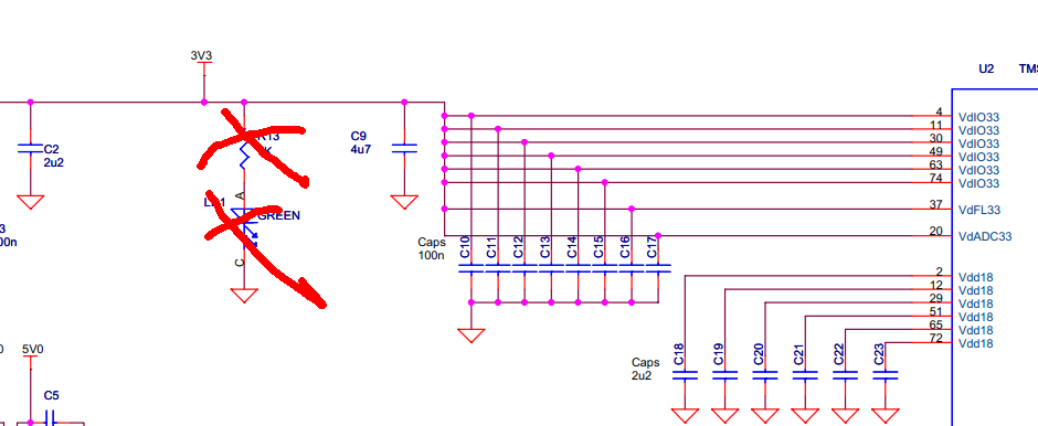

我是TMS320F28069,TQFP100,按照controlSTICK的电路原理图去做板子,供电传输距离不是问题,只有7平方厘米的小板子,EMU0,EMU1上拉了,TRST下拉了.电阻,EMU0,EMU1的上拉电阻是10k,供电是5V,带3.6V的LDO.
  • 原理图呢?特别是电源和JTAG部分的。
    有测量电源引脚电平是正确的吗?
  • JTAG的TRST是3.3K下拉,EMU0,EMU1是10K上拉.电源电平保持在3.3V~3.5V.

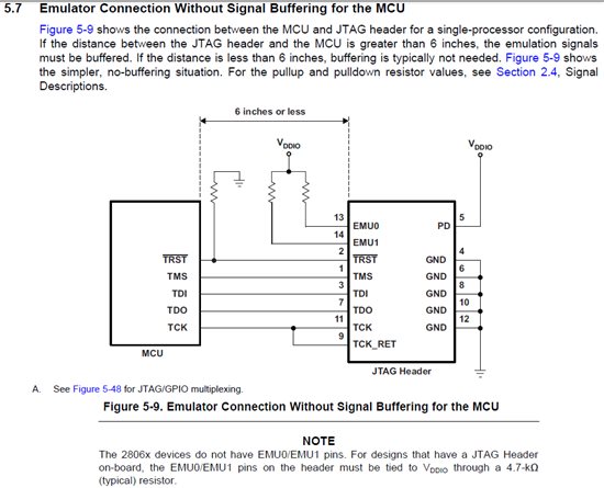

  • 请先按照datasheet 5.7 Emulator Connection Without Signal Buffering for the MCU更改JTAG部分线路测试一下,然后确保电源稳定在3.3V左右:
