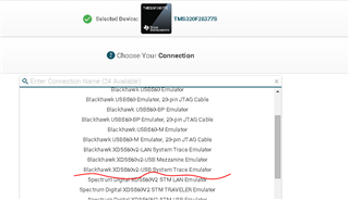

Uniflash can not recognize the emulate kit ,so how can I connect to the kit and use uniflash to program? TKS

Hi Arvin,
What's the version of uniflash you are using? What's the subsequent phenomenon after you click the start? Does the GUI just halt?
I suggest you try to install different version of unflash to try. Notice that blackhawk mentioned that you should install uniflash v5 or later version for XDS560.
Different version of uniflash can be installed on one PC at the same time.
