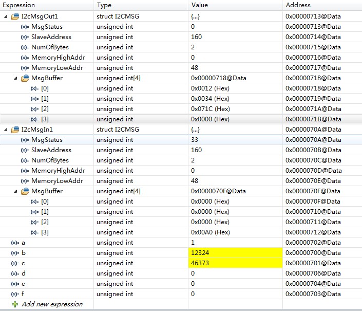

基于launchpad28027的I2C问题
这是controlsuit里面的I2C例程,我稍微修改了下,但是收不了数据,请解答一下,我用的slave是AT24C02

unsigned char c;
interrupt void i2c_int1a_isr(void);
void pass(void);
void fail(void);
#define I2C_SLAVE_ADDR 0xa0//写操作
#define I2C_NUMBYTES 1
#define I2C_EEPROM_HIGH_ADDR 0x02
#define I2C_EEPROM_LOW_ADDR 0x30

for(;;)
// Write data to EEPROM section //
// Check the outgoing message to see if it should be sent.
// In this example it is initialized to send with a stop bit.初始化已经发送停止位
if(I2cMsgOut1.MsgStatus == I2C_MSGSTAT_SEND_WITHSTOP)//I2cMsgOut1.MsgStatus初始值为I2C_MSGSTAT_SEND_WITHSTOP
Error = I2CA_WriteData(&I2cMsgOut1);
// If communication is correctly initiated, set msg status to busy
// and update CurrentMsgPtr for the interrupt service routine.
// Otherwise, do nothing and try again next loop. Once message is
// initiated, the I2C interrupts will handle the rest. Search for
// ICINTR1A_ISR in the i2c_eeprom_isr.c file.
if (Error == I2C_SUCCESS)
{ a++;
CurrentMsgPtr = &I2cMsgOut1;
I2cMsgOut1.MsgStatus = I2C_MSGSTAT_WRITE_BUSY;
// I2cMsgOut1.MsgStatus =I2C_MSGSTAT_SEND_WITHSTOP;
} // end of write section

Uint16 I2CA_WriteData(struct I2CMSG *msg)//写数据
Uint16 i;
// Wait until the STP bit is cleared from any previous master communication.
// Clearing of this bit by the module模块 is delayed until after the SCD bit is
// set. If this bit is not checked prior to initiating a new message, the
// I2C could get confused.
if (I2caRegs.I2CMDR.bit.STP == 1)
return I2C_STP_NOT_READY_ERROR;
}//等待直到停止位被清除
// Setup slave address
I2caRegs.I2CSAR = msg->SlaveAddress;//配置从机地址
// Check if bus busy
if (I2caRegs.I2CSTR.bit.BB == 1)
return I2C_BUS_BUSY_ERROR;
// Setup number of bytes to send
// MsgBuffer + Address// 需要发送的数据个数:=需要发送的数据个数+1个数据长度的地址
I2caRegs.I2CCNT = msg->NumOfBytes+1;//?????????????????
// Setup data to send
I2caRegs.I2CDXR = msg->MemoryHighAddr;
I2caRegs.I2CDXR = msg->MemoryLowAddr;
// for (i=0; i<msg->NumOfBytes-2; i++)
for (i=0; i<msg->NumOfBytes; i++)
I2caRegs.I2CDXR = *(msg->MsgBuffer+i);
}//发送数据
// Send start as master transmitter
I2caRegs.I2CMDR.all = 0x6E20;//主机发送模式
return I2C_SUCCESS;//发送成功标志

if(CurrentMsgPtr->MsgStatus == I2C_MSGSTAT_SEND_NOSTOP_BUSY)
CurrentMsgPtr->MsgStatus = I2C_MSGSTAT_SEND_NOSTOP;
// If completed message was reading EEPROM data, reset msg to inactive state
// and read data from FIFO.
else if (CurrentMsgPtr->MsgStatus == I2C_MSGSTAT_READ_BUSY)
CurrentMsgPtr->MsgStatus = I2C_MSGSTAT_INACTIVE;
for(i=0; i < I2C_NUMBYTES; i++)
CurrentMsgPtr->MsgBuffer[i] = I2caRegs.I2CDRR;
// Check recieved data
if(I2cMsgIn1.MsgBuffer[i] == I2cMsgOut1.MsgBuffer[i])
PassCount++;
else
FailCount++;
if(PassCount == I2C_NUMBYTES)
pass();
else
fail();
} // end of stop condition detected
