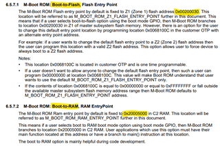

在F28M36技术参考手册6.8.1.2.1 Using the LM FLASH Programmer to Send Data to the M-Boot ROM UART0 Interface – Serial Bootload Option
有这样一段描述”Select the Program tab as shown below and select the bin file built as explained in Section 6.8.1.1.
The Program Address Offset in the snapshot below is the LOAD address for M-Boot ROM to load the
application. The same address is the Application START address. “
请问这个Program Address Offsetthe LOAD address for M-Boot ROM是每个程序都是不同的吗?具体应该根据程序怎么确定这个地址?谢谢!
