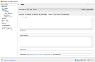

“${CCS_INSTALL_ROOT}/utils/tiobj2bin/tiobj2bin” “${BuildArtifactFileName}” “${BuildArtifactFileBaseName}.bin” “${CG_TOOL_ROOT}/bin/ofd2000” “${CG_TOOL_ROOT}/bin/hex2000” “${CCS_INSTALL_ROOT}/utils/tiobj2bin/mkhex4bin”
您好!!!按照您给的教程我操作之后又出现了下列错误,不知道这种的要如何解决,麻烦指教一下
process_begin: CreateProcess(NULL, 鈥淒:/CCS12.1.0.00007_win64/ccs/utils/tiobj2bin/tiobj2bin鈥? 鈥淪AC-2524-V105.out鈥? 鈥淪AC-2524-V105.bin鈥? 鈥淒:/CCS12.1.0.00007_win64/ccs/tools/compiler/ti-cgt-c2000_22.6.0.LTS/bin/armofd鈥? 鈥淒:/CCS12.1.0.00007_win64/ccs/tools/compiler/ti-cgt-c2000_22.6.0.LTS/bin/armhex鈥? 鈥淒:/CCS12.1.0.00007_win64/ccs/utils/tiobj2bin/mkhex4bin鈥?, ...) failed.
make (e=2): 系统找不到指定的文件。
