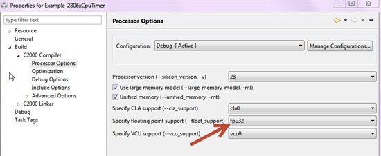

将从controlSUITE中的F2833x FIR 32-bit例子导入到CCS5.2中。在Debug模式下正常编译通过,但在Release模式下遇到了问题。编译报错:
在Console中描述问题的某一点是:
"D:/workspace_v5_2/F28335_FIR32_Example/lib/C28x_FixedPoint_Lib.lib<fir32.ob
   j>" specifies ISA revision "C2800", which is not compatible with ISA
   revision "C28FPU32" specified in a previous file or on the command line
error: file
