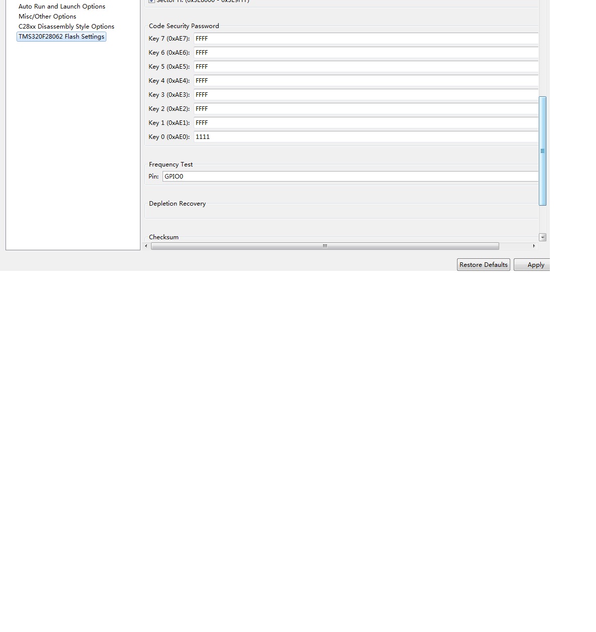

急!F28069的密码设置问题!
      .sect "csmpasswds"
 .if 0
 ; NOTE: If CSM Control is enabled please define the password values
 ;       in bl_config.h
      .int    PWL0        ;PWL0 (LSW of 128-bit password)
      .int    PWL1        ;PWL1
      .int    PWL2        ;PWL2
      .int    PWL3        ;PWL3
      .int    PWL4        ;PWL4
      .int    PWL5        ;PWL5
      .int    PWL6        ;PWL6
      .int    PWL7        ;PWL7 (MSW of 128-bit password)
  .else
 ; NOTE: If CSM Control is disabled please define the password values
 ;       below:
      .int    0x1111       ;PWL0 (LSW of 128-bit password)
      .int    0xFFFF        ;PWL1
      .int    0xFFFF        ;PWL2
      .int    0xFFFF        ;PWL3
      .int    0xFFFF        ;PWL4
      .int    0xFFFF        ;PWL5
      .int    0xFFFF        ;PWL6
      .int    0xFFFF        ;PWL7 (MSW of 128-bit password)
   .endif
; For code security operation, all addresses between 0x3F7F80 and
; 0x3F7FF5 cannot be used as program code or data.  These locations
; must be programmed to 0x0000 when the code security password locations
; (PWL) are programmed.  If security is not a concern, then these addresses
; can be used for code or data.
; The section "csm_rsvd" can be used to program these locations to 0x0000.
        .sect "csm_rsvd"
        .loop (3F7FF5h - 3F7F80h + 1)
         .int 0x0000
        .endloop
各位大牛帮帮忙,我用上面一段代码来加密,但第二次在CCS中设置了相应的密码也连不上芯片?求指点!上图CCS环境设置。
