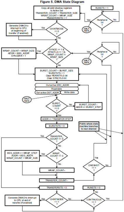

The second is via a process called wrapping, where a wrap address is loaded into the active address pointer. When a wrap procedure occurs, the associated SRC/DST_TRANSFER_STEP register has no effect.
这里的wrapping是什么意思,刚刚接触,不大理解。。
谢谢解答!
