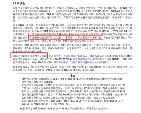

我用ccsv6,烧录用xds100v2,修改密码后设置进去发现无法连接仿真器,Uniflash进行解密,擦除操作无反应,想请教一下芯片加密解密,除了下方操作,还需要改其他内容吗?
错误提示为:
C28xx: Error connecting to the target: (Error -1015 @ 0x0) Device is not responding to the request. Device may be locked, or the debug probe connection may be unreliable. Unlock the device if possible (e.g. use wait in reset mode, and power-cycle the board). If error persists, confirm configuration and/or try more reliable JTAG settings (e.g. lower TCLK). (Emulation package 6.0.222.0)

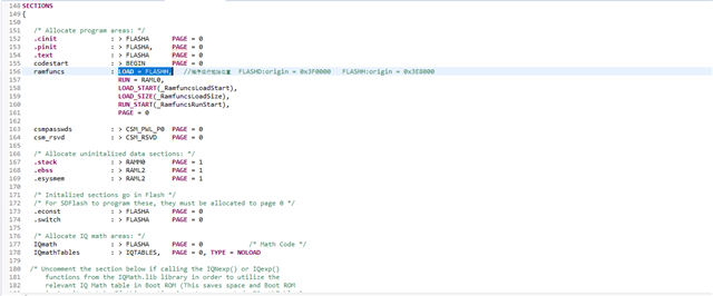

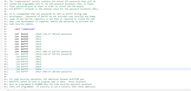

软件设置密码方式为:
cmd修改如下:
bin文件截图:
