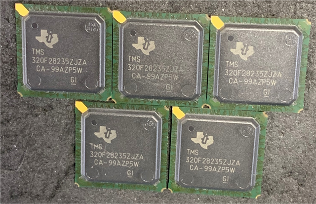

  1. Problem Descriptions
 Programming test failed. Unable to connect during programming.
  1. Verifications
There is no anomaly was found based on the visual inspection.
  • Debug Analysis
  1. Programming test failed. Unable to connect during programming.
  2. Perform verification on the failed part to a known good board. The known good board failed after swapping the defective part. (Failure follow the part)
  3. Replace the defective part. Able to pass FVT.
S/N:
  1. 810-800256-241 D JABM22502331
  2. 810-800256-241 D JABM22502314
  3. 810-800256-241 D JABM22502202
  4. 810-800256-241 D JABM22502193
  5. 810-800256-241 D JABM22502179

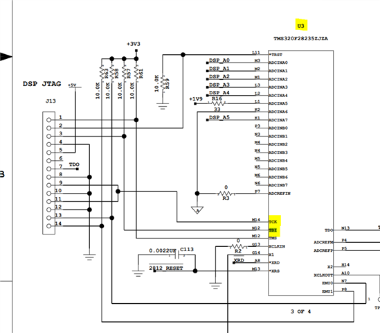

Schematic diagram
