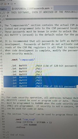

Part Number: TMS320F28035
你好,
TMS320F28035PAGT加密过后,程序烧录进机器后没办法工作;不加密烧录进去可以正常工作。请帮忙找原厂确认一下是什么原因导致的,谢谢!
加密位置:PWL4/PWL5/PWL6/PWL7
你好,
1. 你是在standalone模式下测试的还是在JTAG+CCS连接的情况下测试的?
2. 如果你的代码中有翻转GPIO的操作,并且程序是从Flash中运行的,那么在受保护的器件上会正常工作吗?
Has the customer verified that their boot mode select pins (GPIO34 and GPIO37) are both pulled high? It's possible these pins are configured to be in wait boot mode (GPIO34=0,GPIO37=1), which would cause the device to loop within the BOOTROM until a JTAG probe is connected. Wait boot mode is discussed in section 2.2 of the TRM.
