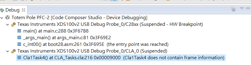

  • 您好
    加載後顯示如下
    執行時顯示下面問題
    CLA_0: Can't Run Target CPU: (Error -2060 @ 0x0) Requested operation cannot be done while device is running. Halt the device, and retry the operation. (Emulation package 6.0.628.3)
    該如何解決
