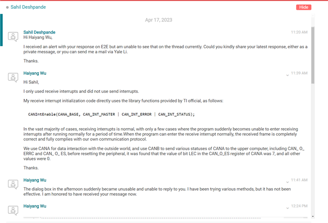

Hi, Yale Li
Today, I suddenly realized that I couldn't communicate with your experts on the link you provided, which is as follows:
After entering this link, when I click "Reply" below the dialog box,the website will pop up as follows:
I am sure I have filled in the correct personal email, but this issue has made me very anxious.
I was just about to reply to your expert's question, but I found that I couldn't reply anymore.
You can reply him here, and I will transmit your reply to him.
Hi,YaleLi
With the consent of your colleague, I have sent him some private emails for communication, as follows:
Thank you for your care.
Today, I have not received a response from your colleague Sahil Deshpande to me. I want to know if he received the message I sent or if he was too busy to remember and reply.
