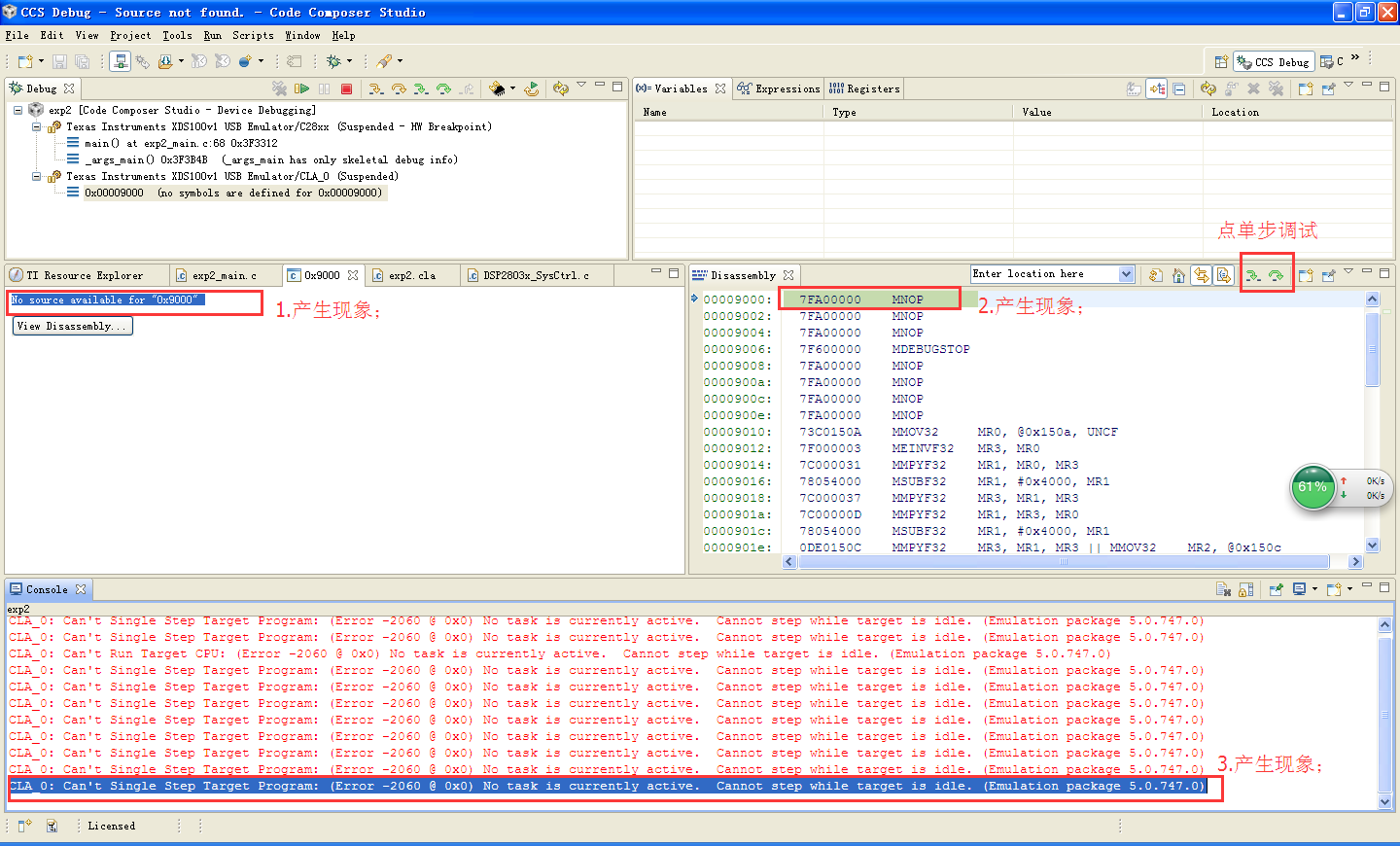

            我刚开始用CLA功能,有很多疑问,想请教下,我在调试时出现如下图情况,点击单步调试,一直提示"CLA_0: Can't Single Step Target Program: (Error -2060 @ 0x0) No task is currently active.  Cannot step while target is idle. (Emulation package 5.0.747.0)“,有空帮我看下,谢谢!
