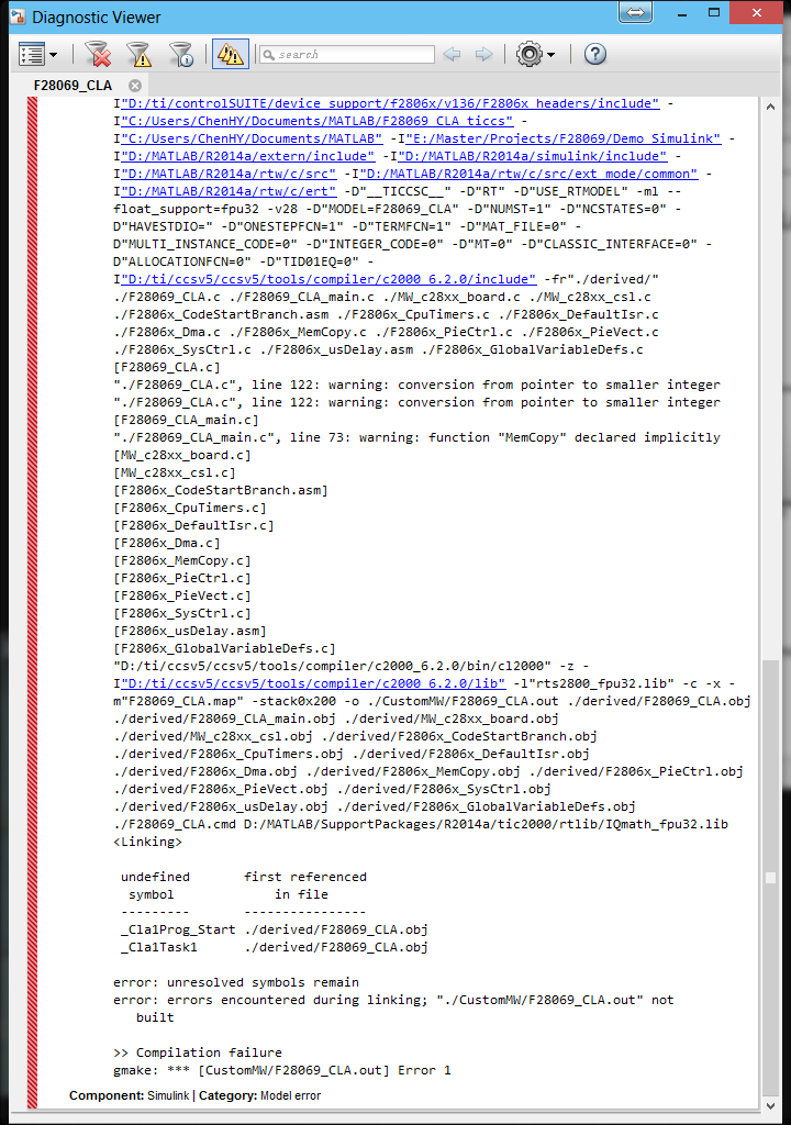

    我在将Simulink自带的“Using the CLA with an LED blinking example”模型生成代码时,遇到了如下错误,请问该如何解决?
我的环境:MATLAB: 2014a
                    CCSv5 (Code Composer Studio) : 5.5.0
                    CGT (Texas Instruments C2000 Code Generation Tools) : 6.2.0
                    DSP/BIOS (Real Time Operating System):5.41.11.38
                    2806x C/C++ Header Files : 1.36
                    Flash Tools (TMS320F2806x Piccolo(TM) Flash API) :1.00
