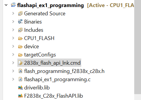

使用的CMD文件为2838x_FLASH_Ink_cpu1.cmd
MEMORY { /* BEGIN is used for the "boot to Flash" bootloader mode */ BEGIN : origin = 0x080000, length = 0x000002 BOOT_RSVD : origin = 0x000002, length = 0x0001AF /* Part of M0, BOOT rom will use this for stack */ RAMM0 : origin = 0x0001B1, length = 0x00024F RAMM1 : origin = 0x000400, length = 0x0003F8 /* on-chip RAM block M1 */ // RAMM1_RSVD : origin = 0x0007F8, length = 0x000008 /* Reserve and do not use for code as per the errata advisory "Memory: Prefetching Beyond Valid Memory" */ RAMD0 : origin = 0x00C000, length = 0x000800 RAMD1 : origin = 0x00C800, length = 0x000800 RAMLS0 : origin = 0x008000, length = 0x000800 RAMLS1 : origin = 0x008800, length = 0x000800 RAMLS2 : origin = 0x009000, length = 0x000800 RAMLS3 : origin = 0x009800, length = 0x000800 RAMLS4 : origin = 0x00A000, length = 0x000800 RAMLS5 : origin = 0x00A800, length = 0x000800 RAMLS6 : origin = 0x00B000, length = 0x000800 RAMLS7 : origin = 0x00B800, length = 0x000800 RAMGS0 : origin = 0x00D000, length = 0x001000 RAMGS1 : origin = 0x00E000, length = 0x001000 RAMGS2 : origin = 0x00F000, length = 0x001000 RAMGS3 : origin = 0x010000, length = 0x001000 RAMGS4 : origin = 0x011000, length = 0x001000 RAMGS5 : origin = 0x012000, length = 0x001000 RAMGS6 : origin = 0x013000, length = 0x001000 RAMGS7 : origin = 0x014000, length = 0x001000 RAMGS8 : origin = 0x015000, length = 0x001000 RAMGS9 : origin = 0x016000, length = 0x001000 RAMGS10 : origin = 0x017000, length = 0x001000 RAMGS11 : origin = 0x018000, length = 0x001000 RAMGS12 : origin = 0x019000, length = 0x001000 RAMGS13 : origin = 0x01A000, length = 0x001000 RAMGS14 : origin = 0x01B000, length = 0x001000 RAMGS15 : origin = 0x01C000, length = 0x000FF8 // RAMGS15_RSVD : origin = 0x01CFF8, length = 0x000008 /* Reserve and do not use for code as per the errata advisory "Memory: Prefetching Beyond Valid Memory" */ /* Flash sectors */ FLASH0 : origin = 0x080002, length = 0x001FFE /* on-chip Flash */ FLASH1 : origin = 0x082000, length = 0x002000 /* on-chip Flash */ FLASH2 : origin = 0x084000, length = 0x002000 /* on-chip Flash */ FLASH3 : origin = 0x086000, length = 0x002000 /* on-chip Flash */ FLASH4 : origin = 0x088000, length = 0x008000 /* on-chip Flash */ FLASH5 : origin = 0x090000, length = 0x008000 /* on-chip Flash */ FLASH6 : origin = 0x098000, length = 0x008000 /* on-chip Flash */ FLASH7 : origin = 0x0A0000, length = 0x008000 /* on-chip Flash */ FLASH8 : origin = 0x0A8000, length = 0x008000 /* on-chip Flash */ FLASH9 : origin = 0x0B0000, length = 0x008000 /* on-chip Flash */ FLASH10 : origin = 0x0B8000, length = 0x002000 /* on-chip Flash */ FLASH11 : origin = 0x0BA000, length = 0x002000 /* on-chip Flash */ FLASH12 : origin = 0x0BC000, length = 0x002000 /* on-chip Flash */ FLASH13 : origin = 0x0BE000, length = 0x001FF0 /* on-chip Flash */ // FLASH13_RSVD : origin = 0x0BFFF0, length = 0x000010 /* Reserve and do not use for code as per the errata advisory "Memory: Prefetching Beyond Valid Memory" */ CPU1TOCPU2RAM : origin = 0x03A000, length = 0x000800 CPU2TOCPU1RAM : origin = 0x03B000, length = 0x000800 CPUTOCMRAM : origin = 0x039000, length = 0x000800 CMTOCPURAM : origin = 0x038000, length = 0x000800 CANA_MSG_RAM : origin = 0x049000, length = 0x000800 CANB_MSG_RAM : origin = 0x04B000, length = 0x000800 RESET : origin = 0x3FFFC0, length = 0x000002 } SECTIONS { codestart : > BEGIN, ALIGN(8) .text : >> FLASH1 | FLASH2 | FLASH3 | FLASH4, ALIGN(8) .cinit : > FLASH4, ALIGN(8) .switch : > FLASH1, ALIGN(8) .reset : > RESET, TYPE = DSECT /* not used, */ .stack : > RAMM1 #if defined(__TI_EABI__) .init_array : > FLASH1, ALIGN(8) .bss : > RAMLS5 .bss:output : > RAMLS3 .bss:cio : > RAMLS5 .data : > RAMLS5 .sysmem : > RAMLS5 /* Initalized sections go in Flash */ .const : > FLASH5, ALIGN(8) #else .pinit : > FLASH1, ALIGN(8) .ebss : > RAMLS5 .esysmem : > RAMLS5 .cio : > RAMLS5 /* Initalized sections go in Flash */ .econst : >> FLASH4 | FLASH5, ALIGN(8) #endif ramgs0 : > RAMGS0, type=NOINIT ramgs1 : > RAMGS1, type=NOINIT MSGRAM_CPU1_TO_CPU2 : > CPU1TOCPU2RAM, type=NOINIT MSGRAM_CPU2_TO_CPU1 : > CPU2TOCPU1RAM, type=NOINIT MSGRAM_CPU_TO_CM : > CPUTOCMRAM, type=NOINIT MSGRAM_CM_TO_CPU : > CMTOCPURAM, type=NOINIT /* The following section definition are for SDFM examples */ Filter_RegsFile : > RAMGS0 Filter1_RegsFile : > RAMGS1, fill=0x1111 Filter2_RegsFile : > RAMGS2, fill=0x2222 Filter3_RegsFile : > RAMGS3, fill=0x3333 Filter4_RegsFile : > RAMGS4, fill=0x4444 Difference_RegsFile : >RAMGS5, fill=0x3333 #if defined(__TI_EABI__) .TI.ramfunc : {} LOAD = FLASH3, RUN = RAMLS0 | RAMLS1 | RAMLS2 |RAMLS3, LOAD_START(RamfuncsLoadStart), LOAD_SIZE(RamfuncsLoadSize), LOAD_END(RamfuncsLoadEnd), RUN_START(RamfuncsRunStart), RUN_SIZE(RamfuncsRunSize), RUN_END(RamfuncsRunEnd), ALIGN(8) #else .TI.ramfunc : {} LOAD = FLASH3, RUN = RAMLS0 | RAMLS1 | RAMLS2 |RAMLS3, LOAD_START(_RamfuncsLoadStart), LOAD_SIZE(_RamfuncsLoadSize), LOAD_END(_RamfuncsLoadEnd), RUN_START(_RamfuncsRunStart), RUN_SIZE(_RamfuncsRunSize), RUN_END(_RamfuncsRunEnd), ALIGN(8) #endif } /* //=========================================================================== // End of file. //=========================================================================== */

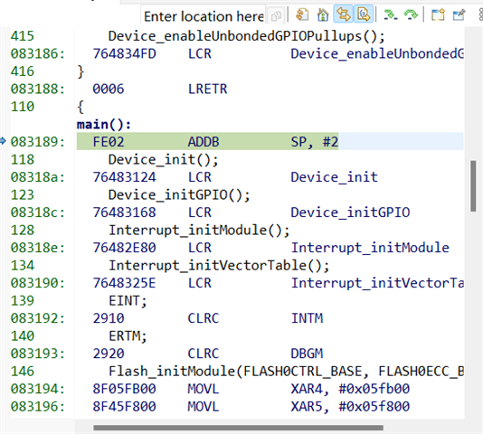

测试文件为driverlib\f2838x\examples\c28x\flash\flashapi_ex1_programming.c
//############################################################################# // // FILE: flashapi_ex1_programming.c // // TITLE: Flash programming example // //! \addtogroup driver_example_list //! <h1> Flash Programming with AutoECC, DataAndECC, DataOnly and EccOnly </h1> //! //! This example demonstrates how to program Flash using API's following options //! 1. AutoEcc generation //! 2. DataOnly and EccOnly //! 3. DataAndECC //! //! \b External \b Connections \n //! - None. //! //! \b Watch \b Variables \n //! - None. //! // //############################################################################# // $Copyright: // Copyright (C) 2022 Texas Instruments Incorporated - http://www.ti.com // // Redistribution and use in source and binary forms, with or without // modification, are permitted provided that the following conditions // are met: // // Redistributions of source code must retain the above copyright // notice, this list of conditions and the following disclaimer. // // Redistributions in binary form must reproduce the above copyright // notice, this list of conditions and the following disclaimer in the // documentation and/or other materials provided with the // distribution. // // Neither the name of Texas Instruments Incorporated nor the names of // its contributors may be used to endorse or promote products derived // from this software without specific prior written permission. // // THIS SOFTWARE IS PROVIDED BY THE COPYRIGHT HOLDERS AND CONTRIBUTORS // "AS IS" AND ANY EXPRESS OR IMPLIED WARRANTIES, INCLUDING, BUT NOT // LIMITED TO, THE IMPLIED WARRANTIES OF MERCHANTABILITY AND FITNESS FOR // A PARTICULAR PURPOSE ARE DISCLAIMED. IN NO EVENT SHALL THE COPYRIGHT // OWNER OR CONTRIBUTORS BE LIABLE FOR ANY DIRECT, INDIRECT, INCIDENTAL, // SPECIAL, EXEMPLARY, OR CONSEQUENTIAL DAMAGES (INCLUDING, BUT NOT // LIMITED TO, PROCUREMENT OF SUBSTITUTE GOODS OR SERVICES; LOSS OF USE, // DATA, OR PROFITS; OR BUSINESS INTERRUPTION) HOWEVER CAUSED AND ON ANY // THEORY OF LIABILITY, WHETHER IN CONTRACT, STRICT LIABILITY, OR TORT // (INCLUDING NEGLIGENCE OR OTHERWISE) ARISING IN ANY WAY OUT OF THE USE // OF THIS SOFTWARE, EVEN IF ADVISED OF THE POSSIBILITY OF SUCH DAMAGE. // $ //############################################################################# // // Included Files // #include "driverlib.h" #include "device.h" // // Include Flash API include file // #include "F021_F2838x_C28x.h" // Include Flash API example header file // #include "flash_programming_f2838x_c28x.h" // // Defines // // // Length (in 16-bit words) of data buffer used for program // #define WORDS_IN_FLASH_BUFFER 0x100 // // Globals // // // Data Buffers used for program operation using the flash API program function // #pragma DATA_SECTION(Buffer,"DataBufferSection"); uint16 Buffer[WORDS_IN_FLASH_BUFFER]; uint32 *Buffer32 = (uint32 *)Buffer; // // Prototype of the functions used in this example // void Example_Error(Fapi_StatusType status); void Example_Done(void); void Example_CallFlashAPI(void); void FMSTAT_Fail(void); void ECC_Fail(void); void Example_EraseSector(void); void Example_ProgramUsingAutoECC(void); void Example_ProgramUsingDataOnlyECCOnly(void); void Example_ProgramUsingDataAndECC(void); // // Main // void main(void) { // // Initialize device clock and peripherals // Copy the Flash initialization code from Flash to RAM // Copy the Flash API from Flash to RAM // Configure Flash wait-states, fall back power mode, performance features // and ECC // Device_init(); // // Initialize GPIO // Device_initGPIO(); // // Initialize PIE and clear PIE registers. Disables CPU interrupts. // Interrupt_initModule(); // // Initialize the PIE vector table with pointers to the shell Interrupt // Service Routines (ISR). // Interrupt_initVectorTable(); // // Enable Global Interrupt (INTM) and realtime interrupt (DBGM) // EINT; ERTM; // // At 200MHz, execution wait-states for external oscillator is 3. Modify the // wait-states when the system clock frequency is changed. // Flash_initModule(FLASH0CTRL_BASE, FLASH0ECC_BASE, 3); // // Pump access must be gained by the core using pump semaphore // #ifdef CPU1 Flash_claimPumpSemaphore(FLASH_CPU1_WRAPPER); #elif defined(CPU2) Flash_claimPumpSemaphore(FLASH_CPU2_WRAPPER); #endif // // Flash API functions should not be executed from the same bank on which // erase/program operations are in progress. // Also, note that there should not be any access to the Flash bank on // which erase/program operations are in progress. Hence below function // is mapped to RAM for execution. // Example_CallFlashAPI(); // // Release the pump access // Flash_releasePumpSemaphore(); // // Example is done here // Example_Done(); } //***************************************************************************** // Example_CallFlashAPI // // This function will interface to the flash API. // Flash API functions used in this function are executed from RAM in this // example. //***************************************************************************** #ifdef __cplusplus #pragma CODE_SECTION(".TI.ramfunc"); #else #pragma CODE_SECTION(Example_CallFlashAPI, ".TI.ramfunc"); #endif void Example_CallFlashAPI(void) { uint16 i = 0; Fapi_StatusType oReturnCheck; // // Initialize the Flash API by providing the Flash register base address // and operating frequency(in MHz). // This function is required to initialize the Flash API based on System // frequency before any other Flash API operation can be performed. // This function must also be called whenever System frequency or RWAIT is // changed. // oReturnCheck = Fapi_initializeAPI(F021_CPU0_BASE_ADDRESS, DEVICE_SYSCLK_FREQ/1000000U); if(oReturnCheck != Fapi_Status_Success) { // // Check Flash API documentation for possible errors // Example_Error(oReturnCheck); } // // Initialize the Flash banks and FMC for erase and program operations. // Fapi_setActiveFlashBank() function sets the Flash banks and FMC for // further Flash operations to be performed on the banks. // oReturnCheck = Fapi_setActiveFlashBank(Fapi_FlashBank0); if(oReturnCheck != Fapi_Status_Success) { // // Check Flash API documentation for possible errors // Example_Error(oReturnCheck); } // // Fill a buffer with data to program into the flash. // for(i=0; i < WORDS_IN_FLASH_BUFFER; i++) { Buffer[i] = i; } // // Program the sector using AutoECC option // Example_ProgramUsingAutoECC(); // // Program the sector using DataOnly and ECCOnly options // Example_ProgramUsingDataOnlyECCOnly(); // // Erase the sector before programming // Example_EraseSector(); // // Program the sector using DataAndECC option // Example_ProgramUsingDataAndECC(); // // Erase the sector for cleaner exit from the example. // Example_EraseSector(); } //***************************************************************************** // Example_ProgramUsingAutoECC // // Example function to Program data in Flash using "AutoEccGeneration" option. // Flash API functions used in this function are executed from RAM in this // example. //***************************************************************************** #ifdef __cplusplus #pragma CODE_SECTION(".TI.ramfunc"); #else #pragma CODE_SECTION(Example_ProgramUsingAutoECC, ".TI.ramfunc"); #endif void Example_ProgramUsingAutoECC(void) { uint32 u32Index = 0; uint16 i = 0; Fapi_StatusType oReturnCheck; Fapi_FlashStatusType oFlashStatus; Fapi_FlashStatusWordType oFlashStatusWord; // // A data buffer of max 8 16-bit words can be supplied to the program // function. // Each word is programmed until the whole buffer is programmed or a // problem is found. However to program a buffer that has more than 8 // words, program function can be called in a loop to program 8 words for // each loop iteration until the whole buffer is programmed. // // Remember that the main array flash programming must be aligned to // 64-bit address boundaries and each 64 bit word may only be programmed // once per write/erase cycle. Meaning the length of the data buffer // (3rd parameter for Fapi_issueProgrammingCommand() function) passed // to the program function can only be either 4 or 8. // // Program data in Flash using "AutoEccGeneration" option. // When AutoEccGeneration option is used, Flash API calculates ECC for the // given 64-bit data and programs it along with the 64-bit main array data. // Note that any unprovided data with in a 64-bit data slice // will be assumed as 1s for calculating ECC and will be programmed. // // Note that data buffer (Buffer) is aligned on 64-bit boundary for verify // reasons. // // Monitor ECC address for the sector below while programming with // AutoEcc mode. // // In this example, the number of bytes specified in the flash buffer // are programmed in the flash sector below along with auto-generated // ECC. // for(i=0, u32Index = Bzero_Sector6_start; (u32Index < (Bzero_Sector6_start + WORDS_IN_FLASH_BUFFER)); i+= 8, u32Index+= 8) { oReturnCheck = Fapi_issueProgrammingCommand((uint32 *)u32Index,Buffer+i, 8, 0, 0, Fapi_AutoEccGeneration); // // Wait until the Flash program operation is over // while(Fapi_checkFsmForReady() == Fapi_Status_FsmBusy); if(oReturnCheck != Fapi_Status_Success) { // // Check Flash API documentation for possible errors // Example_Error(oReturnCheck); } // // Read FMSTAT register contents to know the status of FSM after // program command to see if there are any program operation related // errors // oFlashStatus = Fapi_getFsmStatus(); if(oFlashStatus != 0) { // //Check FMSTAT and debug accordingly // FMSTAT_Fail(); } // // Verify the programmed values. Check for any ECC errors. // oReturnCheck = Fapi_doVerify((uint32 *)u32Index, 4, Buffer32+(i/2), &oFlashStatusWord); if(oReturnCheck != Fapi_Status_Success) { // // Check Flash API documentation for possible errors // Example_Error(oReturnCheck); } } } //***************************************************************************** // Example_ProgramUsingDataOnlyECCOnly // // Example function to Program data in Flash using "DataOnly" option and ECC // using "EccOnly" option. // Flash API functions used in this function are executed from RAM in this // example. //***************************************************************************** #ifdef __cplusplus #pragma CODE_SECTION(".TI.ramfunc"); #else #pragma CODE_SECTION(Example_ProgramUsingDataOnlyECCOnly, ".TI.ramfunc"); #endif void Example_ProgramUsingDataOnlyECCOnly(void) { uint32 u32Index = 0; uint16 i = 0, ECC_B = 0, ECC_LB = 0, ECC_HB = 0; uint64 *LData, *HData, dataLow, dataHigh; Fapi_StatusType oReturnCheck; Fapi_FlashStatusType oFlashStatus; Fapi_FlashStatusWordType oFlashStatusWord; // // Program data using "DataOnly" option and ECC using "EccOnly" option. // // When DataOnly option is used, Flash API will program only the data // portion in Flash at the address specified. // // When EccOnly option is used, Flash API will program only the ECC portion // in Flash ECC memory space (Flash main array address should be provided // for this function and not the corresponding ECC address). // Fapi_calculateEcc is used to calculate the corresponding ECC of the data. // // Note that data buffer (Buffer) is aligned on 64-bit boundary for verify // reasons. // // In this example, 0x100 bytes are programmed in Flash Sector6 // along with the specified ECC. // for(i=0, u32Index = Bzero_Sector6_start; (u32Index < (Bzero_Sector6_start + WORDS_IN_FLASH_BUFFER)); i+= 8, u32Index+= 8) { // // Point LData to the lower 64 bit data // and HData to the higher 64 bit data // LData = (uint64 *)(Buffer32 + i/2); HData = (uint64 *)(Buffer32 + i/2 + 2); // // Calculate ECC for lower 64 bit and higher 64 bit data // ECC_LB = Fapi_calculateEcc(u32Index,*LData); ECC_HB = Fapi_calculateEcc(u32Index+4,*HData); ECC_B = ((ECC_HB<<8) | ECC_LB); oReturnCheck = Fapi_issueProgrammingCommand((uint32 *)u32Index,Buffer+i, 8, 0, 0, Fapi_DataOnly); // // Wait until the Flash program operation is over // while(Fapi_checkFsmForReady() == Fapi_Status_FsmBusy); if(oReturnCheck != Fapi_Status_Success) { // // Check Flash API documentation for possible errors // Example_Error(oReturnCheck); } // // Read FMSTAT register contents to know the status of FSM after // program command to see if there are any program operation related // errors // oFlashStatus = Fapi_getFsmStatus(); if(oFlashStatus != 0) { //Check FMSTAT and debug accordingly FMSTAT_Fail(); } oReturnCheck = Fapi_issueProgrammingCommand((uint32 *)u32Index, 0, 0, &ECC_B, 2, Fapi_EccOnly); // // Wait until the Flash program operation is over // while(Fapi_checkFsmForReady() == Fapi_Status_FsmBusy); if(oReturnCheck != Fapi_Status_Success) { // // Check Flash API documentation for possible errors // Example_Error(oReturnCheck); } // // Read FMSTAT register contents to know the status of FSM after // program command to see if there are any program operation related // errors // oFlashStatus = Fapi_getFsmStatus(); if(oFlashStatus != 0) { // // Check FMSTAT and debug accordingly // FMSTAT_Fail(); } Flash_enableECC(FLASH0ECC_BASE); // // Read back the programmed data to check if there are any ECC failures // dataLow = *(uint64 *)(u32Index); Flash_ErrorStatus errorStatusLow = Flash_getLowErrorStatus(FLASH0ECC_BASE); if((errorStatusLow != FLASH_NO_ERR) || (dataLow != *LData)) { ECC_Fail(); } dataHigh = *(uint64 *)(u32Index + 4); Flash_ErrorStatus errorStatusHigh = Flash_getHighErrorStatus(FLASH0ECC_BASE); if((errorStatusHigh != FLASH_NO_ERR) || (dataHigh != *HData)) { ECC_Fail(); } // // Verify the programmed values. Check for any ECC errors. // oReturnCheck = Fapi_doVerify((uint32 *)u32Index, 4, Buffer32+(i/2), &oFlashStatusWord); if(oReturnCheck != Fapi_Status_Success) { // // Check Flash API documentation for possible errors // Example_Error(oReturnCheck); } } } //***************************************************************************** // Example_ProgramUsingDataAndECC // // Example function to Program data in Flash using "DataAndEcc" option. // Flash API functions used in this function are executed from RAM in this // example. //***************************************************************************** #ifdef __cplusplus #pragma CODE_SECTION(".TI.ramfunc"); #else #pragma CODE_SECTION(Example_ProgramUsingDataAndECC, ".TI.ramfunc"); #endif void Example_ProgramUsingDataAndECC(void) { uint32 u32Index = 0; uint16 i = 0, ECC_B = 0, ECC_LB = 0, ECC_HB = 0; uint64 *LData, *HData, dataLow, dataHigh; Fapi_StatusType oReturnCheck; Fapi_FlashStatusType oFlashStatus; Fapi_FlashStatusWordType oFlashStatusWord; // // Program data and ECC in Flash using "DataAndEcc" option. // When DataAndECC option is used, Flash API will program both the supplied // data and ECC in Flash at the address specified. // Fapi_calculateEcc is used to calculate the corresponding ECC of the data. // // Note that data buffer (Buffer) is aligned on 64-bit boundary for verify // reasons. // // In this example, 0x100 bytes are programmed in Flash Sector6 // along with the specified ECC. // for(i=0, u32Index = Bzero_Sector6_start; (u32Index < (Bzero_Sector6_start + WORDS_IN_FLASH_BUFFER)); i+= 8, u32Index+= 8) { // // Point LData to the lower 64 bit data // and HData to the higher 64 bit data // LData = (uint64 *)(Buffer32 + i/2); HData = (uint64 *)(Buffer32 + i/2 + 2); // // Calculate ECC for lower 64 bit and higher 64 bit data // ECC_LB = Fapi_calculateEcc(u32Index,*LData); ECC_HB = Fapi_calculateEcc(u32Index+4,*HData); ECC_B = ((ECC_HB<<8) | ECC_LB); oReturnCheck = Fapi_issueProgrammingCommand((uint32 *)u32Index,Buffer+i, 8, &ECC_B, 2, Fapi_DataAndEcc); // // Wait until the Flash program operation is over // while(Fapi_checkFsmForReady() == Fapi_Status_FsmBusy); if(oReturnCheck != Fapi_Status_Success) { // // Check Flash API documentation for possible errors // Example_Error(oReturnCheck); } // // Read FMSTAT register contents to know the status of FSM after // program command to see if there are any program operation related // errors // oFlashStatus = Fapi_getFsmStatus(); if(oFlashStatus != 0) { // // Check FMSTAT and debug accordingly // FMSTAT_Fail(); } Flash_enableECC(FLASH0ECC_BASE); // // Read back the programmed data to check if there are any ECC failures // dataLow = *(uint64 *)(u32Index); Flash_ErrorStatus errorStatusLow = Flash_getLowErrorStatus(FLASH0ECC_BASE); if((errorStatusLow != FLASH_NO_ERR) || (dataLow != *LData)) { ECC_Fail(); } dataHigh = *(uint64 *)(u32Index + 4); Flash_ErrorStatus errorStatusHigh = Flash_getHighErrorStatus(FLASH0ECC_BASE); if((errorStatusHigh != FLASH_NO_ERR) || (dataHigh != *HData)) { ECC_Fail(); } // // Verify the programmed values. Check for any ECC errors. // oReturnCheck = Fapi_doVerify((uint32 *)u32Index, 4, Buffer32+(i/2), &oFlashStatusWord); if(oReturnCheck != Fapi_Status_Success) { // // Check Flash API documentation for possible errors // Example_Error(oReturnCheck); } } } //***************************************************************************** // Example_EraseSector // // Example function to Erase data of a sector in Flash. // Flash API functions used in this function are executed from RAM in this // example. //***************************************************************************** #ifdef __cplusplus #pragma CODE_SECTION(".TI.ramfunc"); #else #pragma CODE_SECTION(Example_EraseSector, ".TI.ramfunc"); #endif void Example_EraseSector(void) { Fapi_StatusType oReturnCheck; Fapi_FlashStatusType oFlashStatus; Fapi_FlashStatusWordType oFlashStatusWord; // // Erase the sector that is programmed in the above example // Erase Sector6 // oReturnCheck = Fapi_issueAsyncCommandWithAddress(Fapi_EraseSector, (uint32 *)Bzero_Sector6_start); // // Wait until FSM is done with erase sector operation // while (Fapi_checkFsmForReady() != Fapi_Status_FsmReady){} if(oReturnCheck != Fapi_Status_Success) { // // Check Flash API documentation for possible errors // Example_Error(oReturnCheck); } // // Read FMSTAT register contents to know the status of FSM after // erase command to see if there are any erase operation related errors // oFlashStatus = Fapi_getFsmStatus(); if(oFlashStatus != 0) { // // Check Flash API documentation for FMSTAT and debug accordingly // Fapi_getFsmStatus() function gives the FMSTAT register contents. // Check to see if any of the EV bit, ESUSP bit, CSTAT bit or // VOLTSTAT bit is set (Refer to API documentation for more details). // FMSTAT_Fail(); } // // Verify that Sector6 is erased // oReturnCheck = Fapi_doBlankCheck((uint32 *)Bzero_Sector6_start, Sector64KB_u32length, &oFlashStatusWord); if(oReturnCheck != Fapi_Status_Success) { // // Check Flash API documentation for error info // Example_Error(oReturnCheck); } } //****************************************************************************** // For this example, just stop here if an API error is found //****************************************************************************** void Example_Error(Fapi_StatusType status) { // // Error code will be in the status parameter // __asm(" ESTOP0"); } //****************************************************************************** // For this example, once we are done just stop here //****************************************************************************** void Example_Done(void) { __asm(" ESTOP0"); } //****************************************************************************** // For this example, just stop here if FMSTAT fail occurs //****************************************************************************** void FMSTAT_Fail(void) { __asm(" ESTOP0"); } //****************************************************************************** // For this example, just stop here if ECC fail occurs //****************************************************************************** void ECC_Fail(void) { __asm(" ESTOP0"); } // // End of File //

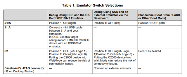

BOOT MODE设置为FLASH启动
使用MCU063B-开发板
