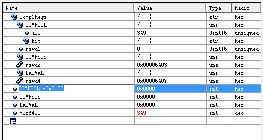

F28027的COMP寄存器如何写入呢
C2000系列的F28027

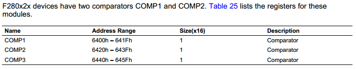

我想使用里面的比较器模块 发现没法写入COMP寄存器
我用了两种程序
1
EALLOW;
AdcRegs.ADCCTL1.bit.ADCBGPWD=1;
Comp1Regs.COMPCTL.bit.COMPDACEN=1;
Comp1Regs.COMPCTL.bit.COMPSOURCE=0;
Comp1Regs.COMPCTL.bit.SYNCSEL=1;
Comp1Regs.COMPCTL.bit.QUALSEL=2;
Comp1Regs.DACVAL.bit.DACVAL=20;
EDIS;
2
COMP_Handle myComp1;
myComp1 = COMP_init((void *)COMP1_BASE_ADDR, sizeof(COMP_Obj));
COMP_enable(myComp1);
COMP_enableDac(myComp1);
COMP_setDacValue(myComp1, 20);

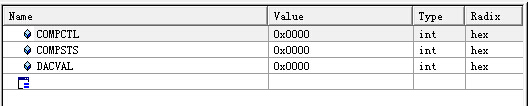

编译后 查看COMP寄存器 发现没有成功写入
