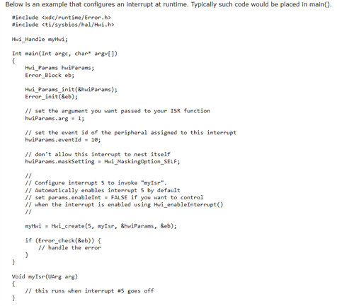

  • 你好,你参考过下面链接中的示例代码吗?
    software-dl.ti.com/.../Hwi.html
  • 是的,SCI相关的中断一直都运行正常的,已经测试一段时间了,现在需要增加can相关的功能和中断,can中断的配置是参照sci做的:

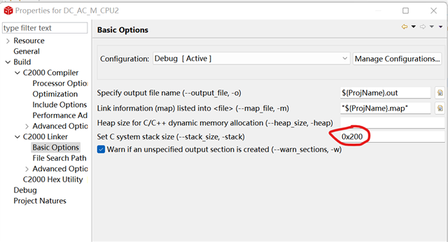

    试过增加堆栈大小吗?
  • 有通过图1界面修改过堆栈大小,将0x200改为0x800,未解决问题。

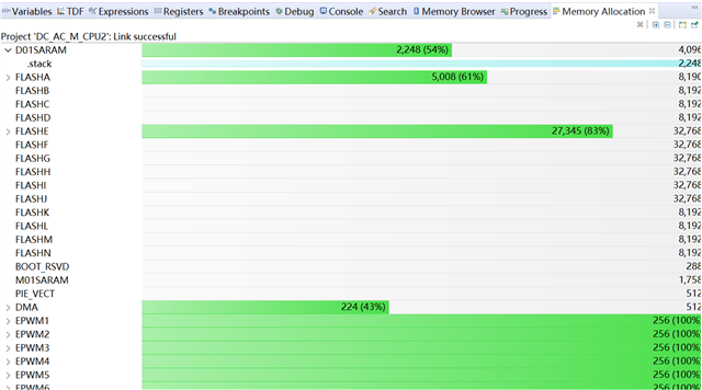

    图2是异常情况下的memory allocation界面显示的内容。

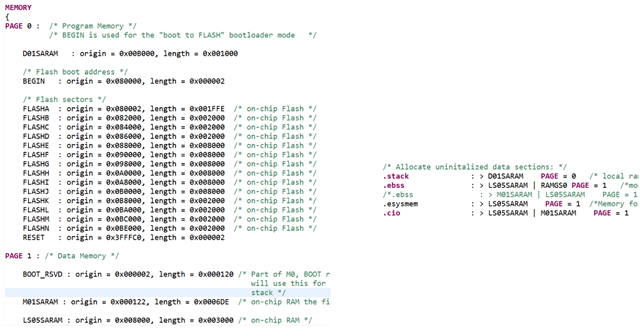

    图3是cmd文件配置

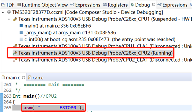

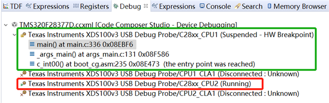

  • 1、如下图所示,在线调试,下载程序后“CPU1的状态是正常的,再手动点击运行按键即可执行CPU1程序”,但是CPU2直接就变为running,实际CPU2并没有执行程序

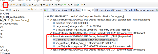

    2、此时点击暂停按键,使CPU2暂停,会变为下图所示的状态

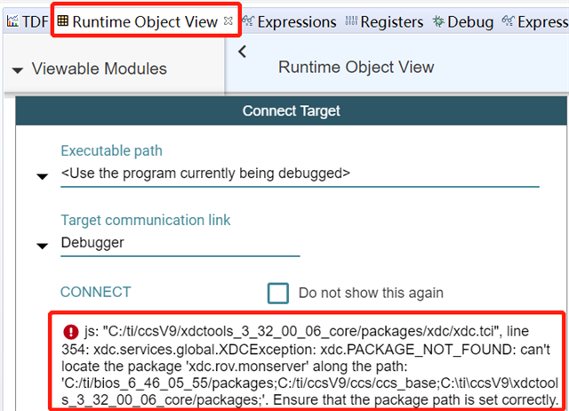

    3、我使用的xdctools的版本为xdctools_3_32_00_06,在ROV中点击connect,会报错
    4、在main中增加ESTOP0,下载程序后,CPU2还是会直接running

  • 2、此时点击暂停按键,使CPU2暂停,会变为下图所示的状态
    所以CPU2 正在启动并跳转到程序入口点,但卡在了 pre-main() SYS/BIOS 初始化代码中。看起来初始化 Hwi 堆栈时可能遇到问题。CPU2应用程序中堆栈放置在哪里?它有多大?增加系统堆栈大小是否会改变行为?
    用ROV Classic试一下。
  • 您好,我这边修改了cfg文件中的BIOS.heapsize,将这个值改小之后,问题解决了。请问,这个空间改小就解决的原理是什么?是否会引起新的问题?
  • 下面是工程师的回复:
    That doesn't really make sense to me. It makes me wonder if making the heap smaller just shifted the stack or some other section into a different memory block and avoided whatever scenario was causing the original issue. You might want to try taking a look at the .map file and see if there were any significant changes to section allocation before and after the heap size change that might explain a difference in behavior.
    Given that this is code running on CPU2, I'd double check which GSxRAM sections are being used an whether or not CPU2 has access to them by the time SYS/BIOS is running its initialization.
