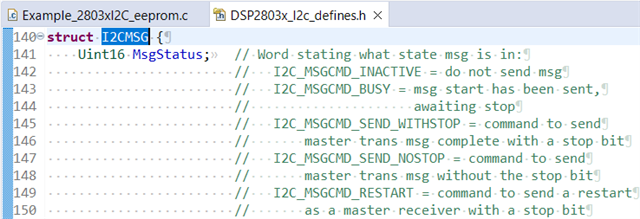

TMS320F28034: 官方的IIC程序问题如下:
Part Number: TMS320F28034
C2000Ware_4_01_00_00\device_support\f2803x\examples\c28\i2c_eeprom文件夹下的文件Example_2803xI2C_eeprom.c
Uint16
I2CA_ReadData(struct I2CMSG *msg)
    // Wait until STP bit is cleared from any previous master communication.
    // Clearing of this bit by the module is delayed until after the SCD bit is
    // set. If this bit is not checked prior to initiating a new message, the
    // I2C could get confused.
    if (I2caRegs.I2CMDR.bit.STP == 1)
      return I2C_STP_NOT_READY_ERROR;
    I2caRegs.I2CSAR = msg->SlaveAddress;
    if(msg->MsgStatus == I2C_MSGSTAT_SEND_NOSTOP)
        // Check if bus busy
        if (I2caRegs.I2CSTR.bit.BB == 1)
            return I2C_BUS_BUSY_ERROR;
        I2caRegs.I2CCNT = 2;
        I2caRegs.I2CDXR = msg->MemoryHighAddr;
        I2caRegs.I2CDXR = msg->MemoryLowAddr;
        I2caRegs.I2CMDR.all = 0x2620;   // Send data to setup EEPROM address
    else if(msg->MsgStatus == I2C_MSGSTAT_RESTART)
        I2caRegs.I2CCNT = msg->NumOfBytes;  // Setup how many bytes to expect
        I2caRegs.I2CMDR.all = 0x2C20;       // Send restart as master receiver
    return I2C_SUCCESS;
I2C_MSGSTAT_SEND_NOSTOP 和 I2C_MSGSTAT_RESTART 两者有什么区别?
我使用的IIC芯片是AT24C02 那么
是否要改成
I2caRegs.I2CCNT = 1;
//I2caRegs.I2CDXR = msg->MemoryHighAddr;
