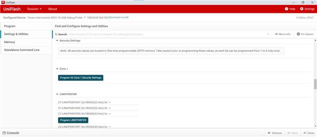

UniFlash也可以配置:
(从截图的部分往下翻,都是配置DCSM的)

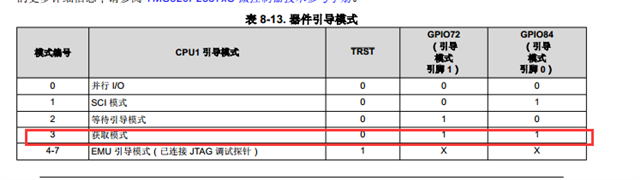

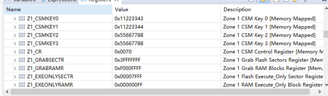

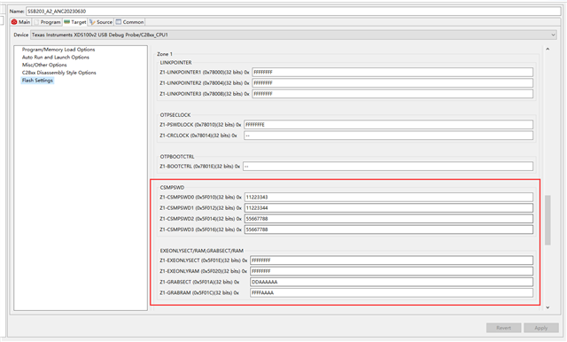

我刚刚在使用uniflash后,输入密码无法解锁,提示
Error connecting to the target: (Error -1156 @ 0x0) Device may be operating in low-power mode. Do you want to bring it out of this mode? Choose 'Yes' to force the device to wake up and retry the operation. Choose 'No' to retry the operation without waking the device. (Emulation package 9.12.0.00150)
是否需要更改boot模式,当前为获取模式
