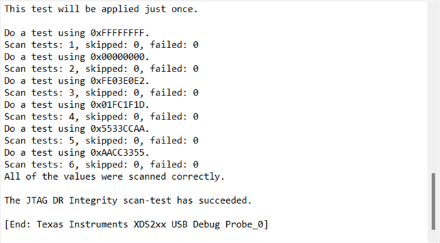

[Start: Texas Instruments XDS2xx USB Debug Probe_0] Execute the command: %ccs_base%/common/uscif/dbgjtag -f %boarddatafile% -rv -o -S integrity [Result] -----[Print the board config pathname(s)]------------------------------------ C:\Users\123\AppData\Local\TEXASI~1\CCS\ ccs1240\0\0\BrdDat\testBoard.dat -----[Print the reset-command software log-file]----------------------------- This utility has selected a 560/2xx-class product. This utility will load the program 'xds2xxu.out'. The library build date was 'Jun 2 2023'. The library build time was '17:37:16'. The library package version is '9.12.0.00150'. The library component version is '35.35.0.0'. The controller does not use a programmable FPGA. The controller has a version number of '13' (0x0000000d). The controller has an insertion length of '0' (0x00000000). This utility will attempt to reset the controller. This utility has successfully reset the controller. -----[Print the reset-command hardware log-file]----------------------------- This emulator does not create a reset log-file. -----[Perform the Integrity scan-test on the JTAG IR]------------------------ This test will use blocks of 64 32-bit words. This test will be applied just once. Do a test using 0xFFFFFFFF. Scan tests: 1, skipped: 0, failed: 0 Do a test using 0x00000000. Scan tests: 2, skipped: 0, failed: 0 Do a test using 0xFE03E0E2. Scan tests: 3, skipped: 0, failed: 0 Do a test using 0x01FC1F1D. Scan tests: 4, skipped: 0, failed: 0 Do a test using 0x5533CCAA. Scan tests: 5, skipped: 0, failed: 0 Do a test using 0xAACC3355. Scan tests: 6, skipped: 0, failed: 0 All of the values were scanned correctly. The JTAG IR Integrity scan-test has succeeded. -----[Perform the Integrity scan-test on the JTAG DR]------------------------ This test will use blocks of 64 32-bit words. This test will be applied just once. Do a test using 0xFFFFFFFF. Scan tests: 1, skipped: 0, failed: 0 Do a test using 0x00000000. Scan tests: 2, skipped: 0, failed: 0 Do a test using 0xFE03E0E2. Scan tests: 3, skipped: 0, failed: 0 Do a test using 0x01FC1F1D. Scan tests: 4, skipped: 0, failed: 0 Do a test using 0x5533CCAA. Scan tests: 5, skipped: 0, failed: 0 Do a test using 0xAACC3355. Scan tests: 6, skipped: 0, failed: 0 All of the values were scanned correctly. The JTAG DR Integrity scan-test has succeeded. [End: Texas Instruments XDS2xx USB Debug Probe_0] Error connecting to the target: (Error -2131 @ 0x0) Unable to access device register. Reset the device, and retry the operation. If error persists, confirm configuration, power-cycle the board, and/or try more reliable JTAG settings (e.g. lower TCLK). (Emulation package 9.12.0.00150)

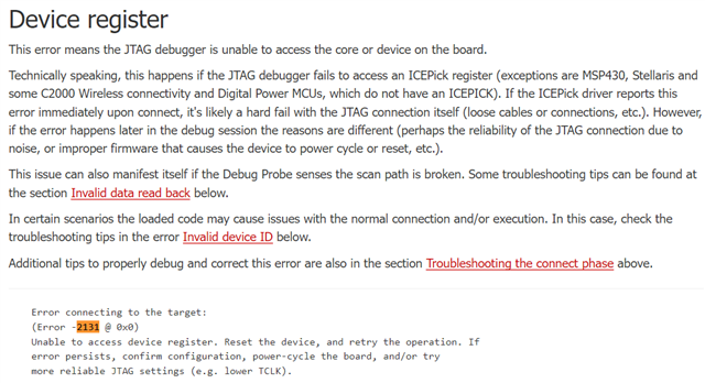

当我可以成功连接芯片时却无法烧录程序,偶尔也会有我无法成功连接芯片却可以烧录程序的情况发生。另外在debug时运行程序,程序会自动跳进exit.c文件,甚至没有进入main函数。
我把你上传的log的格式改了一下,更方便查看。
这个测试检查的是PC到调试器的通路;而报错显示的是调试器到芯片之间的通路有问题。
可以看一下这个链接:
首先应该从物理层面排查。
