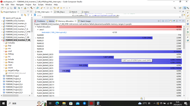

CMD文件出现如下错误信息:
Description Resource Path Location Type
<a href="file:/C:/ti/ccs1110/ccs/tools/compiler/dmed/HTML/10099.html">#10099-D</a> program will not fit into available memory, or the section contains a call site that requires a trampoline that can't be generated for this section. placement with alignment/blocking fails for section ".text" size 0x419d page 0. Available memory ranges: 28004x_generic_flash_lnk.cmd /F280049_Grid_Inverters_T_XB_HYB/cmd line 80 C/C++ Problem

  • 看起来是.text空间分配太小,放不下你的代码
    你可以查看Memory Allocation窗口,其中标注红色的条目表示分配空间出现问题
  •  谢谢回复,显示确实是.text空间分配不够用,但是我还有很多FLASH_BANK0_SEC11,FLASH_BANK0_SEC12,FLASH_BANK0_SEC13,FLASH_BANK0_SEC14,FLASH_BANK1_SEC0-FLASH_BANK1_SEC15都是空的,还没用到,我把它分配给.text也是不行哦!
  • 我现在把CMD文件修改了一下是可以编译通过了:
    /* Flash sectors */
    /* BANK 0 */
    FLASH_BANK0_SEC0 : origin = 0x080002, length = 0x000FFE /* on-chip Flash */
    FLASH_BANK0_SEC1 : origin = 0x081000, length = 0x001000 /* on-chip Flash */
    FLASH_BANK0_SEC2 : origin = 0x082000, length = 0x001000 /* on-chip Flash */
    FLASH_BANK0_SEC3 : origin = 0x083000, length = 0x001000 /* on-chip Flash */
    FLASH_BANK0_SEC4 : origin = 0x084000, length = 0x001000 /* on-chip Flash */
    FLASH_BANK0_SEC5 : origin = 0x085000, length = 0x00A000 /* on-chip Flash */
    //FLASH_BANK0_SEC6 : origin = 0x086000, length = 0x001000 /* on-chip Flash */
    //FLASH_BANK0_SEC7 : origin = 0x087000, length = 0x001000 /* on-chip Flash */
    //FLASH_BANK0_SEC8 : origin = 0x088000, length = 0x001000 /* on-chip Flash */
    //FLASH_BANK0_SEC9 : origin = 0x089000, length = 0x001000 /* on-chip Flash */
    //FLASH_BANK0_SEC10 : origin = 0x08A000, length = 0x001000 /* on-chip Flash */
    //FLASH_BANK0_SEC11 : origin = 0x08B000, length = 0x001000 /* on-chip Flash */
    //FLASH_BANK0_SEC12 : origin = 0x08C000, length = 0x001000 /* on-chip Flash */
    //FLASH_BANK0_SEC13 : origin = 0x08D000, length = 0x001000 /* on-chip Flash */
    //FLASH_BANK0_SEC14 : origin = 0x08E000, length = 0x001000 /* on-chip Flash */
    FLASH_BANK0_SEC15 : origin = 0x08F000, length = 0x001000 /* on-chip Flash */
    就是把长度FLASH_BANK0_SEC6 到FLASH_BANK0_SEC14分配0X1000,统一分配到FLASH_BANK0_SEC5总长度0X00A000;好像这样就可以编译通过
