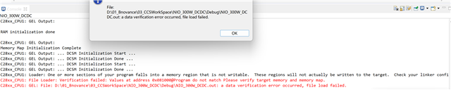

I have replace this file in CCS 12.4 & 11.2, still meet below issue, also i comment
// *(unsigned long *)(DEVCFG_BASE + SYSCTL_O_DC21) = DCX_ENABLE_HIGH | *(unsigned long *)(TI_OTP_ADDR_DC21);
in f280033.gel file
C28xx_CPU1: GEL Output:
Memory Map Initialization Complete
C28xx_CPU1: GEL Output: ... DCSM Initialization Start ...
C28xx_CPU1: GEL Output: ... DCSM Initialization Done ...
C28xx_CPU1: Loader: One or more sections of your program falls into a memory region that is not writable. These regions will not actually be written to the target. Check your linker configuration and/or memory map.
C28xx_CPU1: File Loader: Verification failed: Values at address 0x080000@Program do not match Please verify target memory and memory map.

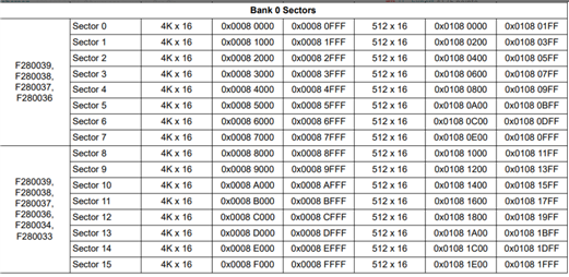

This error has a different verification address (0x80000 whereas before was 0x81000). Also, the Bank 0 Sectors for F280033 start at 0x88000. Can you show what the contents of the memory map are?
