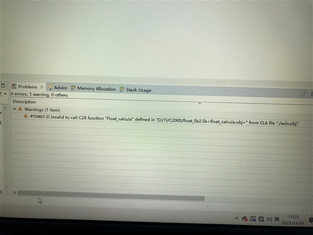

I tried to use his CLA feature, but the following warning appeared at build:
warnings #10461-D :invalid to call C28 function "xxx" defined in"D:/TI/C2000/.../",(Here I use the lib library approach).

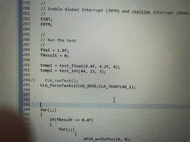

  • I used the CLA asin routine in C2000Ware 5,For some reason, I need to run the float algorithm to generate the lib on one pc and then run the CLA routine on another computer with the lib.
    At first I thought that my float algorithm had integer calculations in it, but now I find that there is something wrong with the lib float call.I made two test functions, as follows:

    After the lib is generated, the two functions are called on the project on another computer for hardware simulation: test_int is perfectly correct, but test_float can only return integers, and this integer follows int c, and whatever c is passed in is whatever the ruture comes out with.

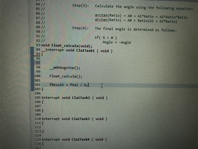

    but the CLA section still reports an error:#10461-D Invalid to cal C28 function "Float calcula" defined in "DyT/C2000/foat lib2.ib<float calculaobi>' from CLA file "/asin.obj"(Here I use the lib library approach).
    I have blocked all integer calculations and integer judgments in lib, and still report errors.
    Is it because other forum posts discuss that.cla files cannot refer to functions in other.c files, only those algorithmic functions can be written in.cla files?
  • This Float_calcula is a function in lib that requires CLA to compute
    This is the opening of CLA in the main function
  • Is it because other forum posts discuss that.cla files cannot refer to functions in other.c files, only those algorithmic functions can be written in.cla files?
    yes, I think it is.
