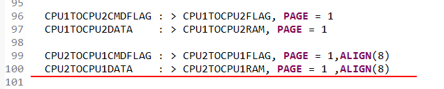

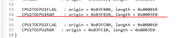

       CPU2与CPU1有一个共享数据。我准备将数据都放到  0x03F810。并且定义了段名称。具体如下:
采用
#pragma DATA_SECTION(SetDataMap,"CPU2TOCPU1DATA");
stSetVale SetDataMap;
编译后发现 map文件中的地址位置与设计的位置 偏移了0x40
不知道这个问题到底是什么原因?
  • 0x3F8000到0x3FFFBF是boot rom区域,不要分配到这一部分。
  • 地址是0x3F800  非0x3F8000
  • 不好意思之前看错了。方便上传一下完整的cmd及map吗?

    PAGE 1 :
    BOOT_RSVD : origin = 0x000002, length = 0x0000A0 /* Part of M0, BOOT rom will use this for stack */
    RAMM1 : origin = 0x000400, length = 0x0003F8 /* on-chip RAM block M1 */
    // RAMM1_RSVD : origin = 0x0007F8, length = 0x000008 /* Reserve and do not use for code as per the errata advisory "Memory: Prefetching Beyond Valid Memory" */
    RAMD1 : origin = 0x00B800, length = 0x000800
    RAMLS5 : origin = 0x00A800, length = 0x000800
    RAMGS0 : origin = 0x00C000, length = 0x001000
    RAMGS1 : origin = 0x00D000, length = 0x001000
    RAMGS2 : origin = 0x00E000, length = 0x001000
    CPU2TOCPU1FLAG : origin = 0x03F800, length = 0x000010
    CPU2TOCPU1RAM : origin = 0x03F810, length = 0x0003E0
    CPU1TOCPU2FLAG : origin = 0x03FC00, length = 0x000010
    CPU1TOCPU2RAM : origin = 0x03FC10, length = 0x0003E0

    SHARERAMGS0 : > RAMGS0, PAGE = 1
    SHARERAMGS1 : > RAMGS1, PAGE = 1
    SHARERAMGS2 : > RAMGS2, PAGE = 1
    CPU1TOCPU2CMDFLAG : > CPU1TOCPU2FLAG, PAGE = 1
    CPU1TOCPU2DATA : > CPU1TOCPU2RAM, PAGE = 1
    CPU2TOCPU1CMDFLAG : > CPU2TOCPU1FLAG, PAGE = 1,ALIGN(8)
    CPU2TOCPU1DATA : > CPU2TOCPU1RAM, PAGE = 1 ,ALIGN(8)

    GROUP : > CPU2TOCPU1RAM, PAGE = 1
    PUTBUFFER
    PUTWRITEIDX
    GETREADIDX
    GROUP : > CPU1TOCPU2RAM, PAGE = 1
    GETBUFFER : TYPE = DSECT
    GETWRITEIDX : TYPE = DSECT
    PUTREADIDX : TYPE = DSECT
