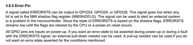

TMS320F280049C: 使用GPIO24引脚采用输入模式时,输入低电压时DSP处于初始化状态,程序不工作。
Part Number: TMS320F280049C
同时配置了GPIO24-28四个端口为输入模式,其余3个端口均能够正常输入,但是GPIO24引脚输入低电平时,DSP程序不运行,且工作状态混乱,请问是什么原因?下面是初始化配置程序:
    GPIO_setDirectionMode(24, GPIO_DIR_MODE_IN);
    GPIO_setDirectionMode(25, GPIO_DIR_MODE_IN);
    GPIO_setDirectionMode(26, GPIO_DIR_MODE_IN);
    GPIO_setDirectionMode(27, GPIO_DIR_MODE_IN);
    GPIO_setPadConfig(24,GPIO_PIN_TYPE_PULLUP);
    GPIO_setPadConfig(25,GPIO_PIN_TYPE_PULLUP);
    GPIO_setPadConfig(26,GPIO_PIN_TYPE_PULLUP);
    GPIO_setPadConfig(27,GPIO_PIN_TYPE_PULLUP);
    GPIO_setPinConfig(GPIO_24_GPIO24);
    GPIO_setPinConfig(GPIO_25_GPIO25);
    GPIO_setPinConfig(GPIO_26_GPIO26);
    GPIO_setPinConfig(GPIO_27_GPIO27);
