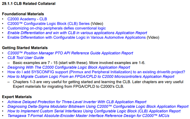

TRM中是相对较全的:
sprui33g_TMS320F28004x Real-Time Microcontrollers Technical Reference Manual (Rev. G) Chapter 29 Configurable Logic Block (CLB)
还可以看一下Academy中CLB相关的培训及实验:
Demo在这里: C:\ti\c2000\C2000Ware_5_01_00_00\driverlib\f28004x\examples\clb
