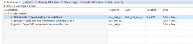

LAUNCHXL-F280039C: 在使用例程adc_ex6_soc_continuous_dma时,无法对变量GpioDataRegs进行操作,显示未定义
Part Number: LAUNCHXL-F280039C
首先,在main函数中对gpio47进行了定义
void set_GPIO_init()
GPIO_setPinConfig(GPIO_47_GPIO47);
GPIO_setPadConfig(ADCItrPin, GPIO_PIN_TYPE_STD);
GPIO_setQualificationMode(ADCItrPin, GPIO_QUAL_SYNC);
GPIO_setDirectionMode(ADCItrPin, GPIO_DIR_MODE_OUT);
GPIO_setControllerCore(ADCItrPin, GPIO_CORE_CPU1);
在ADCA的ADCINT1中断函数中想对47管脚进行翻转操作:
#pragma CODE_SECTION(adcA1ISR, ".TI.ramfunc");
__interrupt void adcA1ISR(void)
//set pin
//GPIO_togglePin(ADCItrPin);
GpioDataRegs.GPBTOGGLE.bit.GPIO47=1;
// Remove ePWM trigger
EPWM_disableADCTrigger(EPWM2_BASE, EPWM_SOC_A);
// Disable this interrupt from happening again
Interrupt_disable(INT_ADCA1);
// Acknowledge interrupt
Interrupt_clearACKGroup(INT_myADC0_1_INTERRUPT_ACK_GROUP);
变量GpioDataRegs在f28003x_gpio.h已被定义为extern,但最终报错为该变量未定义
