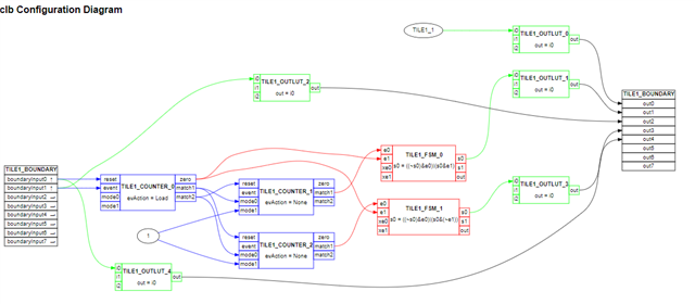

Part Number: TMS320F280039
设计CLB如下,为了测试,OUT 0直接由OUTLUT_0的IN0(配置为1)输出,测试GPIO0输出电平是低电平(理应输出高电平),附上CLB配置步骤,还请帮忙看是不是遗漏了配置,谢谢!

    Clb1LogicCtrlRegs.CLB_OUT_EN = 0xFF;--尝试了0x00,0x0F等配置
    Clb1LogicCfgRegs.CLB_MISC_ACCESS_CTRL.bit.BLKEN = 0;    //CLB_enableOutputMaskUpdates

    ClbOutputXbarRegs.OUTPUTLATCHENABLE.bit.OUTPUT8 = 0;    //disable latch
    ClbOutputXbarRegs.OUTPUTINV.bit.OUTPUT8 = 0;            //don't invert
    ClbOutputXbarRegs.OUTPUT8MUX0TO15CFG.bit.MUX0 = 0;  // CLB1 out0
    ClbOutputXbarRegs.OUTPUT8MUXENABLE.bit.MUX0 = 1;
    ClbOutputXbarRegs.OUTPUTLATCHENABLE.bit.OUTPUT7 = 0;    //disable latch
    ClbOutputXbarRegs.OUTPUTINV.bit.OUTPUT7 = 0;            //don't invert
    ClbOutputXbarRegs.OUTPUT7MUX0TO15CFG.bit.MUX2 = 0;  // CLB1 out2
    ClbOutputXbarRegs.OUTPUT7MUXENABLE.bit.MUX2 = 1;

    //  Output LUT
    //  Equation for Output Look-Up Table Block 0 for TILE1: i0
    //CLB_configOutputLUT(base, CLB_OUT0, TILE1_CFG_OUTLUT_0);
    Clb1LogicCfgRegs.CLB_OUTPUT_LUT_0.bit.IN0 = 8;  //OUT 0输出1
    //  Equation for Output Look-Up Table Block 1 for TILE1: i0
    //CLB_configOutputLUT(base, CLB_OUT1, TILE1_CFG_OUTLUT_1);
    Clb1LogicCfgRegs.CLB_OUTPUT_LUT_1.bit.IN0 = 4;  //FSM_0 STATE_BIT_0

3.GPIO MUX
    EALLOW;
    GpioCtrlRegs.GPAGMUX1.bit.GPIO0 = 2;
    GpioCtrlRegs.GPAMUX1.bit.GPIO0 = 3;    // Configure GPIO0 as CLB output
    GpioCtrlRegs.GPAGMUX1.bit.GPIO1 = 2;
    GpioCtrlRegs.GPAMUX1.bit.GPIO1 = 3;     // Configure GPIO1 as CLB output
    EDIS;
