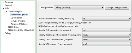

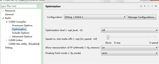

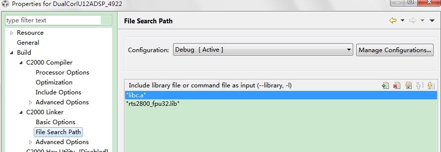

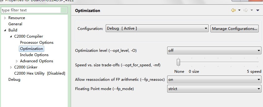

  • 在使用FTU时,编译遇到这样的问题:
    Description Resource Path Location Type
    <a href="file:/c:/ti/ccsv6/tools/compiler/dmed/HTML/16008.html">#16008-D</a> file "../lib/rts2800_fpu32.lib<fd_mpy.obj>" specifies ISA revision "C28FPU32", which is not compatible with ISA revision "C2700" specified in a previous file or on the command line DualCorlU12ADSP_4922 C/C++ Problem
    <a href="file:/c:/ti/ccsv6/tools/compiler/dmed/HTML/16008.html">#16008-D</a> file "../lib/rts2800_fpu32.lib<fd_tol.obj>" specifies ISA revision "C28FPU32", which is not compatible with ISA revision "C2700" specified in a previous file or on the command line DualCorlU12ADSP_4922 C/C++ Problem
    CCSv6.0设置见附件,请问可能是什么原因,感谢您的帮助!(fp_mode 改为relaxed也不行)
