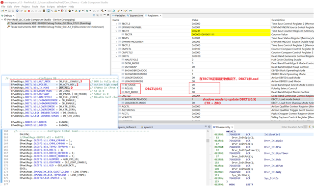

Part Number: TMS320F280039C
DB死区模块 DBCTL[5:0]可以通过DBCTL2配置为shadow load,以及选择在CTR=ZRO的时刻进行load,但是没有调试显示没有load成功,进而影响了发波
还配置了GLDCTL2来全局加载DBCTL,其他的TBPRD都是可以成功加载的,以下是我的寄存器代码配置:(代码中关于DC和TZ的代码配置可忽略)

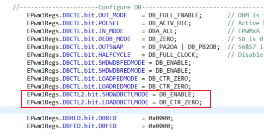

    //----------------------Configure DB---------------------------------------------------
        EPwm1Regs.DBCTL.bit.OUT_MODE    = DB_FULL_ENABLE;       // DBM is fully disabled or by-passed.
        EPwm1Regs.DBCTL.bit.POLSEL      = DB_ACTV_HIC;          // Active high complementary (AHC). EPWMxB is inverted.
        EPwm1Regs.DBCTL.bit.IN_MODE     = DBA_ALL;              // EPWMxA In (from the action-qualifier) is the source for both falling-edge and rising-edge delay.
        EPwm1Regs.DBCTL.bit.DEDB_MODE   = DB_ZERO;              // S8 is 0
        EPwm1Regs.DBCTL.bit.OUTSWAP     = DB_PA2OA | DB_PB2OB;  // S6&S7 is 0
        EPwm1Regs.DBCTL.bit.HALFCYCLE   = DB_FULL_CLOCK;        // Disable half clock
        EPwm1Regs.DBCTL.bit.SHDWDBFEDMODE = DB_ENABLE;
        EPwm1Regs.DBCTL.bit.SHDWDBREDMODE = DB_ENABLE;
        EPwm1Regs.DBCTL.bit.LOADFEDMODE = DB_CTR_ZERO;
        EPwm1Regs.DBCTL.bit.LOADREDMODE = DB_CTR_ZERO;
        EPwm1Regs.DBCTL2.bit.SHDWDBCTLMODE = DB_ENABLE;
        EPwm1Regs.DBCTL2.bit.LOADDBCTLMODE = DB_CTR_ZERO;

我还利用driverLib中的库函数进行了配置,结果是一样的。
以下是DEBUG调试截图:
请问关于这个配置以及现象,有什么见解吗?
