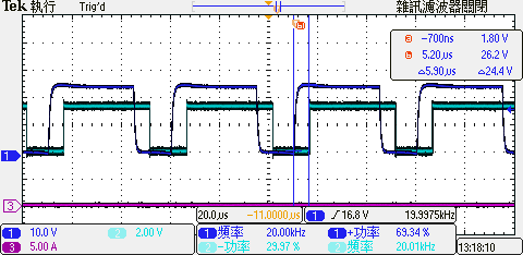

TMS320F28035: 輸出的pwm1&2訊號不同步
Part Number: TMS320F28035
試想設置兩個pwm1&2訊號可是不知是我哪裡程式有問題,導致訊號不同步

        EPwm2Regs.AQCTLA.bit.PRD=AQ_SET;
        if (IADC > ty2)
            EPwm2Regs.CMPA.half.CMPA=EPwm1Regs.TBCTR;
            EPwm2Regs.AQCTLA.bit.CAU=AQ_CLEAR;
        else
            EPwm2Regs.CMPA.half.CMPA = 260;
void EPwm1()
    EPwm1Regs.TBPRD = 3750;                         // TPWM=(TBPRD + 1) x TBCLK=1Mhz
    EPwm1Regs.TBPHS.half.TBPHS = 0x0000;           // Phase 為 0
    EPwm1Regs.TBCTR = 0x0000;                      // 清除 counter
    EPwm1Regs.TBCTL.bit.CTRMODE = TB_COUNT_UPDOWN;     // 設置為向上計數模式
    EPwm1Regs.TBCTL.bit.PHSEN = TB_DISABLE;        // Disable phase loading
    EPwm1Regs.TBCTL.bit.SYNCOSEL = TB_CTR_ZERO;
    EPwm1Regs.TBCTL.bit.HSPCLKDIV = TB_DIV1;   // Clock ratio to SYSCLKOUT(150M)
    EPwm1Regs.TBCTL.bit.CLKDIV = TB_DIV1;
    EPwm1Regs.CMPCTL.bit.SHDWAMODE = CC_SHADOW;    // 在計數器為零時讀新的CMP值
    EPwm1Regs.CMPCTL.bit.SHDWBMODE = CC_SHADOW;
    EPwm1Regs.CMPCTL.bit.LOADAMODE = CC_CTR_ZERO;
    EPwm1Regs.CMPCTL.bit.LOADBMODE = CC_CTR_ZERO;
    EPwm1Regs.CMPA.half.CMPA = 1125;                // 設置比較暫存器,對應於50%佔空比
    //EPwm1Regs.CMPB = 1125;
    EPwm1Regs.AQCTLB.bit.CAU = AQ_SET;           // 設置 PWM1A 為 1
    EPwm1Regs.AQCTLB.bit.CAD = AQ_CLEAR;
    EPwm1Regs.ETSEL.bit.SOCAEN = 1;           // Enable SOC on A group
          EPwm1Regs.ETSEL.bit.SOCASEL = 2;          // Select SOC from TBCTR=TBPRD
          EPwm1Regs.ETPS.bit.SOCAPRD = 1;           // Generate pulse on every event
void EPwm2()
    EPwm2Regs.TBPRD = 7499;                        // 100kHz
    EPwm2Regs.TBPHS.half.TBPHS = 0x0000;           // Phase 為 0
    EPwm2Regs.TBCTR = 0x0000;                      // 清除 counter
    EPwm2Regs.TBCTL.bit.CTRMODE = TB_COUNT_UP;     // 設置為向上數模式
    EPwm2Regs.TBCTL.bit.PHSEN = TB_DISABLE;            // Disable phase loading
    EPwm2Regs.TBCTL.bit.SYNCOSEL = TB_CTR_ZERO;
    EPwm2Regs.TBCTL.bit.HSPCLKDIV = TB_DIV1;   // Clock ratio to SYSCLKOUT(150M)
    EPwm2Regs.TBCTL.bit.CLKDIV = TB_DIV1;
    EPwm2Regs.CMPCTL.bit.SHDWAMODE = CC_SHADOW;    // 在計數器為零時讀新的CMP值
    EPwm2Regs.CMPCTL.bit.SHDWBMODE = CC_SHADOW;
    EPwm2Regs.CMPCTL.bit.LOADAMODE = CC_CTR_ZERO;
    EPwm2Regs.CMPCTL.bit.LOADBMODE = CC_CTR_ZERO;
    EPwm2Regs.CMPA.half.CMPA = 5250;
