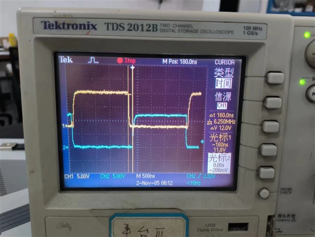

本意是想配置两路PWM信号,其中PWM2与PWM1相位差180,但是按照如图所示的方式配置后,输出结果仍有几十ns的误差,不知是何原因

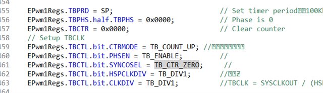

  • void Setup_ePWM1(void)
    //	EALLOW;
    //	SysCtrlRegs.PCLKCR0.bit.TBCLKSYNC = 0;
    //	SysCtrlRegs.PCLKCR1.bit.EPWM1ENCLK = 1;
    //	EDIS;
        EPwm1Regs.TBPRD = SP;                          //
        EPwm1Regs.TBPHS.half.TBPHS = 0x0000;           // Phase is 0
        EPwm1Regs.TBCTR = 0x0000;                      // Clear counter
        // Setup TBCLK
        EPwm1Regs.TBCTL.bit.CTRMODE = TB_COUNT_UP; //
        EPwm1Regs.TBCTL.bit.PHSEN = TB_ENABLE;         //
        EPwm1Regs.TBCTL.bit.SYNCOSEL = TB_CTR_ZERO;     //
        EPwm1Regs.TBCTL.bit.HSPCLKDIV = TB_DIV1;       //�
        EPwm1Regs.TBCTL.bit.CLKDIV = TB_DIV1;          //TBCLK = SYSCLKOUT / (HSPCLKDIV �� CLKDIV)=60M
        EPwm1Regs.CMPCTL.bit.SHDWAMODE = CC_SHADOW;    // Load registers every ZERO
        EPwm1Regs.CMPCTL.bit.SHDWBMODE = CC_SHADOW;
        EPwm1Regs.CMPCTL.bit.LOADAMODE = CC_CTR_ZERO;
        EPwm1Regs.CMPCTL.bit.LOADBMODE = CC_CTR_ZERO;
        // Setup compare
        EPwm1Regs.CMPA.half.CMPA = CMP1A;              //
        // Set actions
        EPwm1Regs.AQCTLA.bit.CAU = AQ_SET;             // Set PWM1A on CAU��TBCTR=CMPA
        EPwm1Regs.AQCTLA.bit.PRD = AQ_CLEAR;		   // Clear PWM1A on CAD,TBCTR=CMPA
        EPwm1Regs.AQCTLB.bit.CAU = AQ_SET;             // Set PWM1B on CAU��TBCTR=CMPA
        EPwm1Regs.AQCTLB.bit.PRD = AQ_CLEAR;           // Clear PWM1B on CAD,TBCTR=CMPA
        // Active Low PWMs - Setup Deadband
        EPwm1Regs.DBCTL.bit.OUT_MODE = DB_FULL_ENABLE;//
        EPwm1Regs.DBCTL.bit.POLSEL = DB_ACTV_HIC;     //
        EPwm1Regs.DBCTL.bit.IN_MODE = DBA_RED_DBB_FED;//A
        EPwm1Regs.DBRED = DT;                         //
        EPwm1Regs.DBFED = DT;
        // Assumes ePWM1 clock is already enabled in InitSysCtrl();
        EPwm1Regs.ETSEL.bit.SOCAEN  = 1;    // Enable SOC on A group
        EPwm1Regs.ETSEL.bit.SOCASEL = 4;    // TBCTR = 0
        EPwm1Regs.ETPS.bit.SOCAPRD  = 1;    // Generate pulse on 1st event

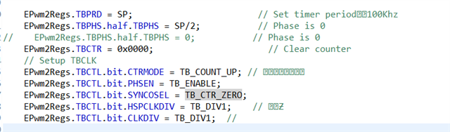

    void Setup_ePWM2(void)
    //	EALLOW;
    //	SysCtrlRegs.PCLKCR1.bit.EPWM2ENCLK = 1;
    //	EDIS;
        EPwm2Regs.TBPRD = SP;                        //
        EPwm2Regs.TBPHS.half.TBPHS = SP/2;           // Phase is 0
    //    EPwm2Regs.TBPHS.half.TBPHS = 0;           // Phase is 0
        EPwm2Regs.TBCTR = 0x0000;                      // Clear counter
        // Setup TBCLK
        EPwm2Regs.TBCTL.bit.CTRMODE = TB_COUNT_UP; //
        EPwm2Regs.TBCTL.bit.PHSEN = TB_ENABLE;
        EPwm2Regs.TBCTL.bit.SYNCOSEL = TB_CTR_ZERO;
        EPwm2Regs.TBCTL.bit.HSPCLKDIV = TB_DIV1;    //
        EPwm2Regs.TBCTL.bit.CLKDIV = TB_DIV1;  //
        EPwm2Regs.CMPCTL.bit.SHDWAMODE = CC_SHADOW;    // Load registers every ZERO
        EPwm2Regs.CMPCTL.bit.SHDWBMODE = CC_SHADOW;
        EPwm2Regs.CMPCTL.bit.LOADAMODE = CC_CTR_ZERO;
        EPwm2Regs.CMPCTL.bit.LOADBMODE = CC_CTR_ZERO;
        // Setup compare
        EPwm2Regs.CMPA.half.CMPA = CMP1A;                //
        // Set action
        EPwm2Regs.AQCTLA.bit.CAU = AQ_SET;             // Set PWM2A on CAU
        EPwm2Regs.AQCTLA.bit.PRD = AQ_CLEAR;           // Clear PWM2A on CAD
        EPwm2Regs.AQCTLB.bit.CAU = AQ_SET;             // Set PWM2B on CAU
        EPwm2Regs.AQCTLB.bit.PRD = AQ_CLEAR;           // Clear PWM2B on CAD
        // Active Low complementary PWMs - setup the deadband
        EPwm2Regs.DBCTL.bit.OUT_MODE = DB_FULL_ENABLE;//
        EPwm2Regs.DBCTL.bit.POLSEL = DB_ACTV_HIC;     //
        EPwm2Regs.DBCTL.bit.IN_MODE = DBA_RED_DBB_FED;//
        EPwm2Regs.DBRED = DT;                         //
        EPwm2Regs.DBFED = DT;
    //	EALLOW;
    //	SysCtrlRegs.PCLKCR0.bit.TBCLKSYNC = 1;         // Start all the timers synced
    //	EDIS;
  • 示波器中不同颜色分别代表什么信号?
    同步配置没有问题,我推测几十ns的间隙大概率是由DB延时引起的。可以先把DB关掉,确认配置好同步后再打开。
  • 示波器不同颜色波形对应了两个模块输出的PWM信号,EPWM1A,EPWM2A,其中蓝色是移相180后的波形。
    我会先试试关掉DB
  • 好的,你先排查一下
