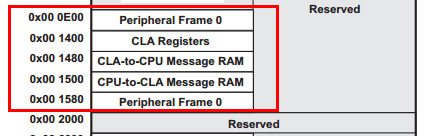

各位看下,这是28033片子下CLA出现这个问题,怎么回事呢?
Description Resource Path Location Type
#10010 errors encountered during linking; "H32.out" not built H941AU112V8132 C/C++ Problem
#10264 CLA1_MSGRAMHIGH memory range F28033.cmd /H941AU112V8132/CMD line 110 C/C++ Problem
#10264 CLA1_MSGRAMLOW memory range F28033.cmd /H941AU112V8132/CMD line 109 C/C++ Problem
CMD文件

照着数据手册上去分配CLA地址是没有错的,问题出在哪了呢?
