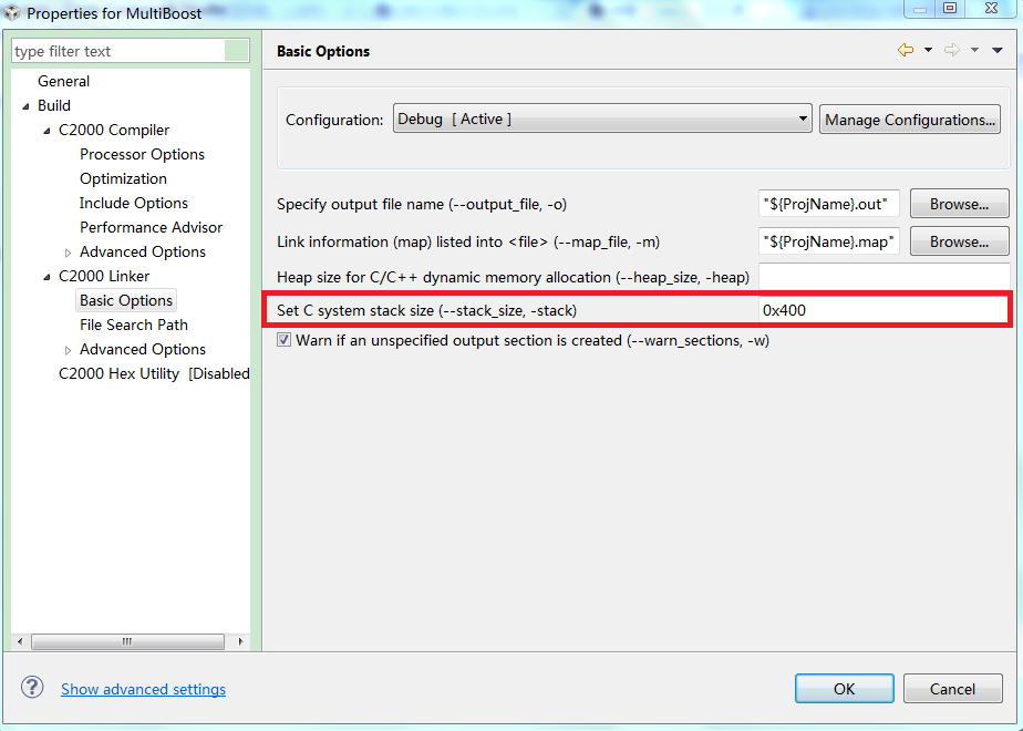

编译遇到告警:
#10210-D creating ".stack" section with default size of 0x400; use the -stack option to change the default size

该告警信息该如何排除?谢谢。
