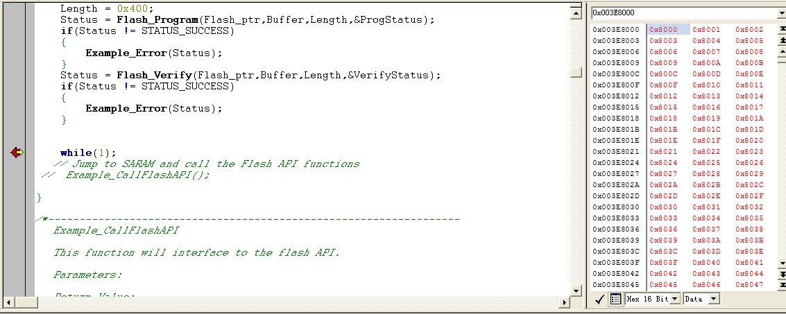

Flash_Erase((SECTORB|SECTORC|SECTORE),&EraseStatus);
for(i=0;i<0x400;i++)
Buffer[i] = 0x8000+i;
}Flash_ptr = (Uint16 *)0x003E8000;
Length = 0x400;
Status = Flash_Program(Flash_ptr,Buffer,Length,&ProgStatus);
if(Status != STATUS_SUCCESS)
Example_Error(Status);
Status = Flash_Verify(Flash_ptr,Buffer,Length,&VerifyStatus);
while(1);//在此处断点通过view->memory 查看0x003E8000开始的地址下数据已经修改为0x8000,0x8001...

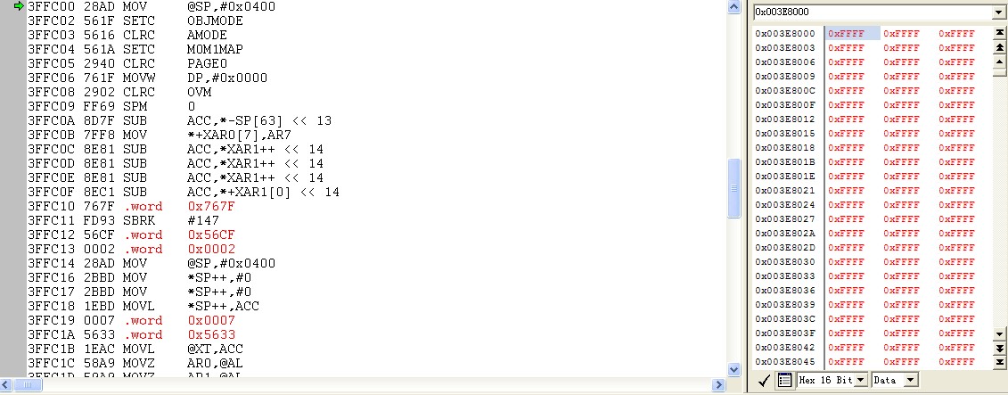

断开仿真器断电,再上电memory 数据全部变成0XFFFF (仿真器为SEED-XDS510-PLUS )
问题:内部FLASH为什么会掉电丢失?要如何让他掉电不丢失?
