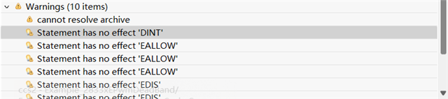

When running the official program, I changed the location of the program, and after modifying the "properties", there is currently a warning left: "DINT", "EALLOW" and "EDIS" have no effect, what is the problem?

What properties specifically did you modify? Looks like there may have been an issue with the files associated with the project. Can you double check the file search path in your project properties is valid?
