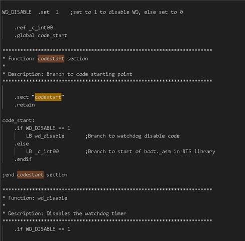

你好,怎样才能正确的F28377S CMD文件,请提供标准的CMD文件。另外请问怎样跳到code_start:,请参考截图

  • 请问怎样跳到code_start:
  • 您好
    您分享的的是调用后的运行过程,怎么跳转应结合CMD配置相关字段在存储中,调用过程从标识字段起点运行后回到主程序的制定入口。根据您分享只显示定义函数和函数运行,没有CMD配置过程。只能做如上说明。
  • MEMORY
    PAGE 0 :  /* Program Memory */
              /* Memory (RAM/FLASH) blocks can be moved to PAGE1 for data allocation */
       RAMM0           	: origin = 0x000122, length = 0x0002DE
       RAMD0           	: origin = 0x00B000, length = 0x000800
       RAMLS0          	: origin = 0x008000, length = 0x000800
       RAMLS1          	: origin = 0x008800, length = 0x000800
       RAMLS2      		: origin = 0x009000, length = 0x000800
       RAMLS3      		: origin = 0x009800, length = 0x000800
       RAMLS4      		: origin = 0x00A000, length = 0x000800
       RAMGS14     		: origin = 0x01A000, length = 0x001000
       RAMGS15     		: origin = 0x01B000, length = 0x001000
       RESET           	: origin = 0x3FFFC0, length = 0x000002
    #ifdef __TI_COMPILER_VERSION__
       #if __TI_COMPILER_VERSION__ >= 20012000
    GROUP {      /* GROUP memory ranges for crc/checksum of entire flash */
       #endif
    #endif
        /* BEGIN is used for the "boot to Flash" bootloar mode   */
    	BEGIN           	: origin = 0x080000, length = 0x000002
    	/* Flash sectors */
       FLASHA           : origin = 0x080002, length = 0x001FFE	/* on-chip Flash */
       FLASHB           : origin = 0x082000, length = 0x002000	/* on-chip Flash */
       FLASHC           : origin = 0x084000, length = 0x002000	/* on-chip Flash */
       FLASHD           : origin = 0x086000, length = 0x002000	/* on-chip Flash */
       FLASHE           : origin = 0x088000, length = 0x008000	/* on-chip Flash */
       FLASHF           : origin = 0x090000, length = 0x008000	/* on-chip Flash */
       FLASHG           : origin = 0x098000, length = 0x008000	/* on-chip Flash */
       FLASHH           : origin = 0x0A0000, length = 0x008000	/* on-chip Flash */
       FLASHI           : origin = 0x0A8000, length = 0x008000	/* on-chip Flash */
       FLASHJ           : origin = 0x0B0000, length = 0x008000	/* on-chip Flash */
       FLASHK           : origin = 0x0B8000, length = 0x002000	/* on-chip Flash */
       FLASHL           : origin = 0x0BA000, length = 0x002000	/* on-chip Flash */
       FLASHM           : origin = 0x0BC000, length = 0x002000	/* on-chip Flash */
       FLASHN           : origin = 0x0BE000, length = 0x002000	/* on-chip Flash */
       FLASHO           : origin = 0x0C0000, length = 0x002000	/* on-chip Flash */
       FLASHP           : origin = 0x0C2000, length = 0x002000	/* on-chip Flash */
       FLASHQ           : origin = 0x0C4000, length = 0x002000	/* on-chip Flash */
       FLASHR           : origin = 0x0C6000, length = 0x002000	/* on-chip Flash */
       FLASHS           : origin = 0x0C8000, length = 0x008000	/* on-chip Flash */
       FLASHT           : origin = 0x0D0000, length = 0x008000	/* on-chip Flash */
       FLASHU           : origin = 0x0D8000, length = 0x008000	/* on-chip Flash */
       FLASHV           : origin = 0x0E0000, length = 0x008000	/* on-chip Flash */
       FLASHW           : origin = 0x0E8000, length = 0x008000	/* on-chip Flash */
       FLASHX           : origin = 0x0F0000, length = 0x008000	/* on-chip Flash */
       FLASHY           : origin = 0x0F8000, length = 0x002000	/* on-chip Flash */
       FLASHZ           : origin = 0x0FA000, length = 0x002000	/* on-chip Flash */
       FLASHAA          : origin = 0x0FC000, length = 0x002000	/* on-chip Flash */
       FLASHBB          : origin = 0x0FE000, length = 0x001FF0	/* on-chip Flash */
       FLASHBB_DO_NOT_USE     : origin = 0x0FFFF0, length = 0x000010    /* Reserve and do not use for code as per the errata advisory "Memory: Prefetching Beyond Valid Memory" */
    }  crc(_ccs_flash_checksum, algorithm=C28_CHECKSUM_16)
      #endif
    #endif
    PAGE 1 : /* Data Memory */
             /* Memory (RAM/FLASH) blocks can be moved to PAGE0 for program allocation */
       BOOT_RSVD       : origin = 0x000002, length = 0x000120     /* Part of M0, BOOT rom will use this for stack */
       RAMM1           : origin = 0x000400, length = 0x000400     /* on-chip RAM block M1 */
       RAMD1           : origin = 0x00B800, length = 0x000800
       RAMLS5      : origin = 0x00A800, length = 0x000800
       RAMGS0      : origin = 0x00C000, length = 0x001000
       RAMGS1      : origin = 0x00D000, length = 0x001000
       RAMGS2      : origin = 0x00E000, length = 0x001000
       RAMGS3      : origin = 0x00F000, length = 0x001000
       RAMGS4      : origin = 0x010000, length = 0x001000
       RAMGS5      : origin = 0x011000, length = 0x001000
       RAMGS6      : origin = 0x012000, length = 0x001000
       RAMGS7      : origin = 0x013000, length = 0x001000
       RAMGS8      : origin = 0x014000, length = 0x001000
       RAMGS9      : origin = 0x015000, length = 0x001000
       RAMGS10     : origin = 0x016000, length = 0x001000
       RAMGS11     : origin = 0x017000, length = 0x001000
       RAMGS12     : origin = 0x018000, length = 0x001000
       RAMGS13     : origin = 0x019000, length = 0x001000
    SECTIONS
       /* Allocate program areas: */
       .cinit              : > FLASHB      PAGE = 0, ALIGN(4)
       .pinit              : > FLASHB,     PAGE = 0, ALIGN(4)
       .text               : >> FLASHB | FLASHC | FLASHD | FLASHE      PAGE = 0, ALIGN(4)
       codestart           : > BEGIN       PAGE = 0, ALIGN(4)
       #if __TI_COMPILER_VERSION__ >= 15009000
        .TI.ramfunc : {} LOAD = FLASHD,
                             RUN = RAMLS0 | RAMLS1 | RAMLS2 |RAMLS3,
                             LOAD_START(_RamfuncsLoadStart),
                             LOAD_SIZE(_RamfuncsLoadSize),
                             LOAD_END(_RamfuncsLoadEnd),
                             RUN_START(_RamfuncsRunStart),
                             RUN_SIZE(_RamfuncsRunSize),
                             RUN_END(_RamfuncsRunEnd),
                             PAGE = 0, ALIGN(4)
       #else
       ramfuncs            : LOAD = FLASHD,
                             LOAD_SIZE(_RamfuncsLoadSize),   hailing
                             PAGE = 0, ALIGN(4)
       #endif
    #endif
       /* Allocate uninitalized data sections: */
       .stack              : > RAMM1        PAGE = 1
       .ebss               : >> RAMLS5 | RAMGS0 | RAMGS1       PAGE = 1
       .esysmem            : > RAMLS5       PAGE = 1
       /* Initalized sections go in Flash */
       .econst             : >> FLASHF | FLASHG | FLASHH      PAGE = 0, ALIGN(4)
       .switch             : > FLASHB      PAGE = 0, ALIGN(4)
       .reset              : > RESET,     PAGE = 0, TYPE = DSECT /* not used, */
       /* crc/checksum section configured as COPY section to avoid including in executable */
       .TI.memcrc          : type = COPY
    // End of file.
