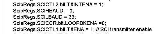

void scib_fifo_init(void)
ScibRegs.SCICCR.all =0x0007;
ScibRegs.SCICTL1.all =0x0003;
ScibRegs.SCICTL2.bit.RXBKINTENA = 1;
ScibRegs.SCICTL2.bit.TXINTENA = 1;
ScibRegs.SCIHBAUD = 0;
ScibRegs.SCILBAUD = 39;
SciaRegs.SCICCR.bit.LOOPBKENA =0;
ScibRegs.SCICTL1.bit.TXENA = 1; // SCI transmitter enable
ScibRegs.SCICTL1.bit.RXENA = 1; // SCI receiver enable
ScibRegs.SCICTL1.bit.SWRESET = 1;
