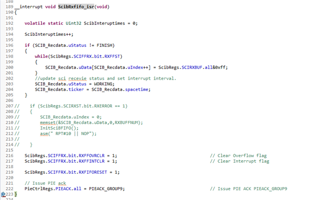

接收中断函数:
__interrupt void ScibRxfifo_isr(void)
volatile static Uint32 ScibInteruptimes = 0;
ScibInteruptimes++;
if (SCIB_Recdata.uStatus != FINISH)
while(ScibRegs.SCIFFRX.bit.RXFFST)
SCIB_Recdata.uData[SCIB_Recdata.uIndex++] = ScibRegs.SCIRXBUF.all&0xff;
//update sci recevie status and set interrupt interval.
SCIB_Recdata.uStatus = WORKING;
SCIB_Recdata.ticker = SCIB_Recdata.spacetime;
ScibRegs.SCIFFRX.bit.RXFFOVRCLR = 1; // Clear Overflow flag
ScibRegs.SCIFFRX.bit.RXFFINTCLR = 1; // Clear Interrupt flag
ScibRegs.SCIFFRX.bit.RXFIFORESET = 1;
// Issue PIE ack
PieCtrlRegs.PIEACK.all = PIEACK_GROUP9; // Issue PIE ACK PIEACK_GROUP9

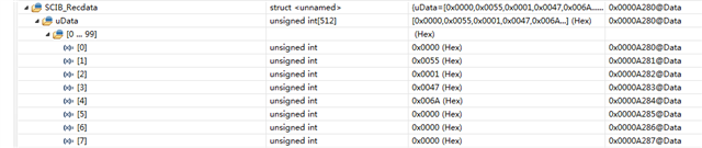

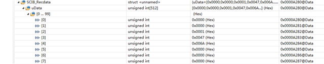

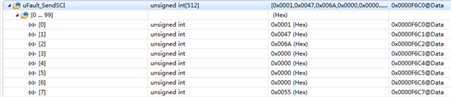

当我发送的8个字节时
我在串口中断收到的数为:
