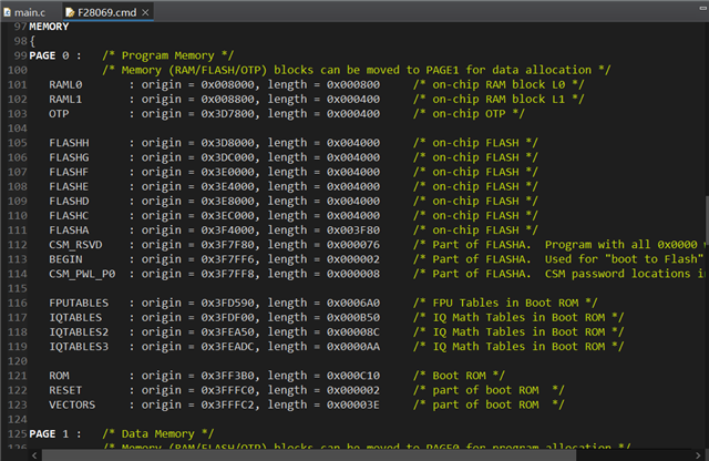

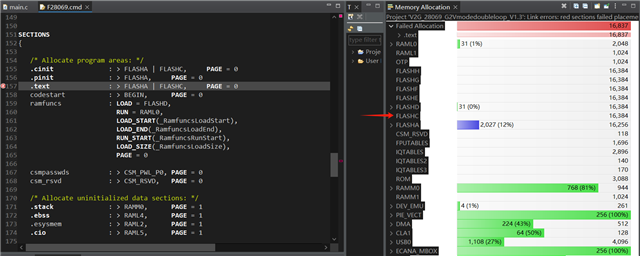

我的FLASHA区和FLSHC区都没有存满,但是这个.text依旧显示内存满了。我试了下,加上D区和E区也是如下报错,这是为什么?
Description Resource Path Location Type
<a href="file:/D:/ti/ccs1220/ccs/tools/compiler/dmed/HTML/10099.html">#10099-D</a> program will not fit into available memory, or the section contains a call site that requires a trampoline that can't be generated for this section. placement with alignment/blocking fails for section ".text" size 0x41c5 page 0. Available memory ranges: F28069.cmd /28069_V1.3/DSP2806x_Library line 157 C/C++ Problem
您好,
您能分享一下错误消息吗?
您能否尝试使用以下配置并确认是否仍然遇到问题 -
.text : >> FLASHA, FLASHC PAGE = 0
