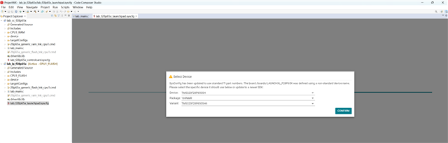

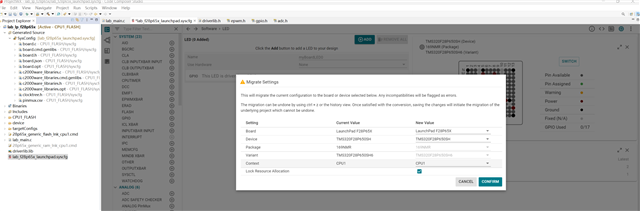

The CCS version is 12.8.1,No PTP package is available, only 169NMR,how to solve it?
Hi,
Change the "Board" setting to "None" (from the LaunchPad) and you should be able to select the PTP package.
