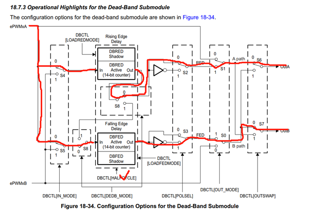

PWM1A和PWM1B配置位死区互补形式输出,调整CMPA的值,改变Duty;
PWM1A和PWM1B是否都能实现互补形式的高精度输出?

  • 实际测试问题情况是这样的:PWM1A的下降沿会按照CMPAHR调整值进行变化,但是PWM1B的上升沿不对对应的变化。
    DB没块的配置如下:
    HRPWM配置如下:
    // Hi-res PWM
    // MEP control on both edges.
    HRPWM_setMEPEdgeSelect(base1, HRPWM_CHANNEL_A, HRPWM_MEP_CTRL_FALLING_EDGE);
    HRPWM_setCounterCompareShadowLoadEvent(base1, HRPWM_CHANNEL_A, HRPWM_LOAD_ON_CNTR_ZERO_PERIOD);
    HRPWM_setMEPControlMode(base1, HRPWM_CHANNEL_A, HRPWM_MEP_DUTY_PERIOD_CTRL);
    HRPWM_setDeadbandMEPEdgeSelect(base1, HRPWM_DB_MEP_CTRL_RED_FED);
    HRPWM_setRisingEdgeDelayLoadMode(base1, HRPWM_LOAD_ON_CNTR_ZERO_PERIOD);
    HRPWM_setFallingEdgeDelayLoadMode(base1, HRPWM_LOAD_ON_CNTR_ZERO_PERIOD);
    // Enable autoconversion
    HRPWM_enableAutoConversion(base1);
    // Turn on high-resolution period control.
    HRPWM_enablePeriodControl(base1);
