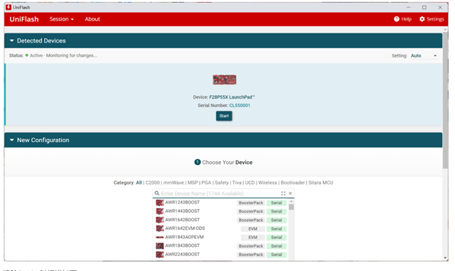

问题背景:

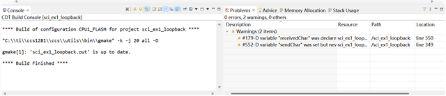

在将基于官方例程的RFFT功能迁移到自己的工程后,编译器没有报错,程序成功下载,但是下载之后开发板卡死。
之后尝试再次进行程序下载与调试,工程编译均无报错,有警告(警告为有两个变量未使用),但是再也无法将该程序成功下载到开发板。
尝试更换为官方例程led_ex1_blinky,也无法下载到开发板,具有相同报错。
尝试使用UniFlash观察寄存器值,擦除FLASH等操作,均报错无法执行。
更换开发板,在烧录该问题工程之前,新开发板都可以正常使用(包括官方例程),烧录该工程之后出现与第一块开发板同样的问题。

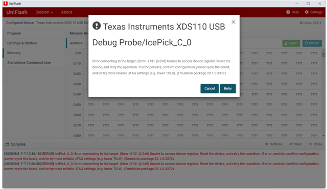

具体报错:

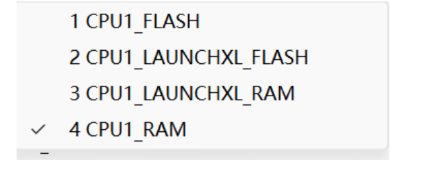

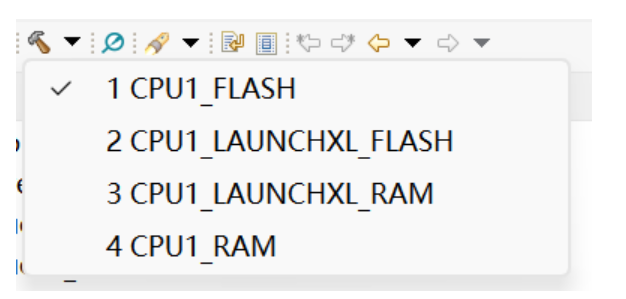

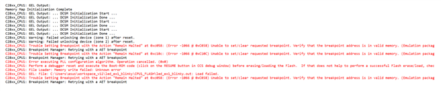

当使用RAM模式编译工程后,下载时报错如下:
C28xx_CPU1: GEL Output: Memory Map Initialization Complete C28xx_CPU1: GEL Output: ... DCSM Initialization Start ... C28xx_CPU1: GEL Output: ... DCSM Initialization Done ... C28xx_CPU1: GEL Output: ... DCSM Initialization Start ... C28xx_CPU1: GEL Output: ... DCSM Initialization Done ... C28xx_CPU1: File Loader: Verification failed: Values at address 0x000000@Program do not match Please verify target memory and memory map. C28xx_CPU1: GEL: File: C:\Users\asus\workspace_v12\led_ex1_blinky\CPU1_RAM\led_ex1_blinky.out: a data verification error occurred, file load failed.
当使用FLASH模式编译工程后,下载时报错如下:
C28xx_CPU1: GEL Output: Memory Map Initialization Complete C28xx_CPU1: GEL Output: ... DCSM Initialization Start ... C28xx_CPU1: GEL Output: ... DCSM Initialization Done ... C28xx_CPU1: GEL Output: ... DCSM Initialization Start ... C28xx_CPU1: GEL Output: ... DCSM Initialization Done ... C28xx_CPU1: GEL Output: ... DCSM Initialization Start ... C28xx_CPU1: GEL Output: ... DCSM Initialization Done ... C28xx_CPU1: Warning: Failed unlocking device (zone 1) after reset. C28xx_CPU1: Warning: Failed unlocking device (zone 2) after reset. C28xx_CPU1: Trouble Setting Breakpoint with the Action "Remain Halted" at 0xc058: (Error -1066 @ 0xC058) Unable to set/clear requested breakpoint. Verify that the breakpoint address is in valid memory. (Emulation package 20.0.0.3178) C28xx_CPU1: Breakpoint Manager: Retrying with a AET breakpoint C28xx_CPU1: Trouble Setting Breakpoint with the Action "Remain Halted" at 0xc10c: (Error -1066 @ 0xC10C) Unable to set/clear requested breakpoint. Verify that the breakpoint address is in valid memory. (Emulation package 20.0.0.3178) C28xx_CPU1: Breakpoint Manager: Retrying with a AET breakpoint C28xx_CPU1: Error executing PLL configuration algorithm. Operation cancelled. (0x0) C28xx_CPU1: Perform a debugger reset and execute the Boot-ROM code (click on the RESUME button in CCS debug window) before erasing/loading the Flash. If that does not help to perform a successful Flash erase/load, check the Reset cause (RESC) register, NMI shadow flag (NMISHDFLG) register and the Boot-ROM status register for further debug. C28xx_CPU1: File Loader: Memory write failed: Unknown error C28xx_CPU1: GEL: File: C:\Users\asus\workspace_v12\led_ex1_blinky\CPU1_FLASH\led_ex1_blinky.out: Load failed. C28xx_CPU1: Trouble Setting Breakpoint with the Action "Remain Halted" at 0xc058: (Error -1066 @ 0xC058) Unable to set/clear requested breakpoint. Verify that the breakpoint address is in valid memory. (Emulation package 20.0.0.3178) C28xx_CPU1: Breakpoint Manager: Retrying with a AET breakpoint
使用UniFlash,可以识别开发板但是无法连接,具体如下 :
[2025/5/8 下午10:36:38] [ERROR] IcePick_C_0: Error connecting to the target: (Error -2131 @ 0x0) Unable to access device register. Reset the device, and retry the operation. If error persists, confirm configuration, power-cycle the board, and/or try more reliable JTAG settings (e.g. lower TCLK). (Emulation package 20.1.0.3372)
可以识别到开发板

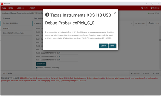

擦除FLASH时报错如下
读取寄存器时报错相同
