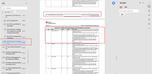

Part Number: LAUNCHXL-F28P65X
The DMA done flag(DMA_DONE_RIS) is not set after I trigger the DMA to complete the data transfer using sync0/sync1 signals.So, I would like to ask under what circumstances will this flag be set?

There isn't much documentation about this register bit, as you've probably noticed. I'll need to track down more information about it and get back to you later.
Can you tell me if IRQ_RIS, SYNC0_RIS, or SYNC1_RIS are getting set during your tests? Also, you have verified the DMA is indeed getting triggered by SYNC0/1 and transfer is completing?

我现在有答案了。DMA_DONE_RIS似乎特定于F2838x设备上的CMμDMA。因此,它应该从只有C28x内核的F28P65x设备中删除。
