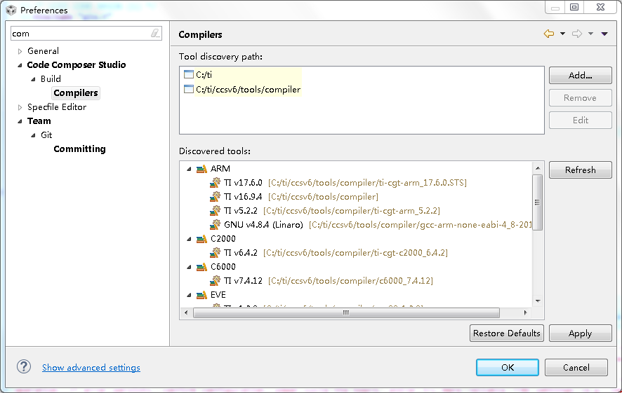

CCS6 导入TMS570LS1227 工程时,提示its compiler definition is not available. Please install the ARMv15.12 compiler
Other Parts Discussed in Thread: TMS570LS1227
See details below.
Error: Import failed for project 'dpp-qv' because its compiler definition is not available. Please install the ARMv15.12 compiler before importing this project - click 'View > CCS App Center' to check if compiler updates are available, or install the compiler manually and register it with CCS through 'Preferences > CCS > Build > Compilers'.
CCS6 导入TMS570LS1227 工程时 有上面的错误提示,要怎样解决,谢谢

  • 已经安装,还是报
    See details below.
    Error: Import failed for project 'BMS' because its compiler definition is not available. Please install the ARMv15.12 compiler before importing this project - click 'View > CCS App Center' to check if compiler updates are available, or install the compiler manually and register it with CCS through 'Preferences > CCS > Build > Compilers'.
    1\CCS App Center 中的TI ARM COMPILER已经更新
    还要怎样处理?
  • 在C:\CCS7\ccsv7\tools\compiler以及ccs中Window->Preferences->Code Composer Studio->Build->Compilers能看到该版本编译器吗?是否存在没安装好的情况呢。
  • 已经解决
    方法:
    1、按提示,到这里下载相应的compiler
    http://software-dl.ti.com/codegen/non-esd/downloads/download.htm#ARM
    2、安装时,安装到
    C:\ti\ccsv6\tools\compiler
    3、在下面refresh
    添加安装的compiler 。
