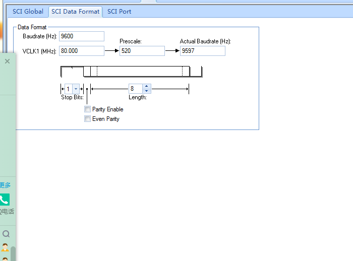

硬件平台:launchPad TMS570ls12x
软件:我是按照HAL code generator 的帮助文档中的教程操作的,结果成功了,串口功能使用正常,但是该教程是针对SCI2的,
如图一:
所以我照葫芦画瓢,重新新建了CCS工程,以及使用HAL code generator 使能了SCI,
如图二
main.c代码如下

然后生成了代码,并在main函数中参照SCI2修改了相应的代码.但是用示波器测量SCITX端口发现始终为低电平,没有任何数据信号.
请教一下大家,SCI的使用跟SCI2有什么需要特别注意的地方么?
void sciInit(void) { /* USER CODE BEGIN (2) */ /* USER CODE END */ /** @b initialize @b SCI */ /** - bring SCI out of reset */ sciREG->GCR0 = 0U; sciREG->GCR0 = 1U; sciREG->GCR1 &= ~(1<<8u); /** - Disable all interrupts */ sciREG->CLEARINT = 0xFFFFFFFFU; sciREG->CLEARINTLVL = 0xFFFFFFFFU; /** - global control 1 */ sciREG->GCR1 = (uint32)((uint32)1U << 25U) /* enable transmit */ | (uint32)((uint32)1U << 24U) /* enable receive */ | (uint32)((uint32)1U << 5U) /* internal clock (device has no clock pin) */ | (uint32)((uint32)(1U-1U) << 4U) /* number of stop bits */ | (uint32)((uint32)0U << 3U) /* even parity, otherwise odd */ | (uint32)((uint32)0U << 2U) /* enable parity */ | (uint32)((uint32)1U << 1U) /* asynchronous timing mode */ | (uint32)((uint32)1U << 16U); /** - set baudrate */ sciREG->BRS = 520U; /* baudrate */ /** - transmission length */ sciREG->FORMAT = 8U - 1U; /* length */ /** - set SCI pins functional mode */ sciREG->PIO0 = (uint32)((uint32)1U << 2U) /* tx pin */ | (uint32)((uint32)1U << 1U); /* rx pin */ /** - set SCI pins default output value */ sciREG->PIO3 = (uint32)((uint32)0U << 2U) /* tx pin */ | (uint32)((uint32)0U << 1U); /* rx pin */ /** - set SCI pins output direction */ sciREG->PIO1 = (uint32)((uint32)0U << 2U) /* tx pin */ | (uint32)((uint32)0U << 1U); /* rx pin */ /** - set SCI pins open drain enable */ sciREG->PIO6 = (uint32)((uint32)0U << 2U) /* tx pin */ | (uint32)((uint32)0U << 1U); /* rx pin */ /** - set SCI pins pullup/pulldown enable */ sciREG->PIO7 = (uint32)((uint32)0U << 2U) /* tx pin */ | (uint32)((uint32)0U << 1U); /* rx pin */ /** - set SCI pins pullup/pulldown select */ sciREG->PIO8 = (uint32)((uint32)1U << 2U) /* tx pin */ | (uint32)((uint32)1U << 1U); /* rx pin */ /** - set interrupt level */ sciREG->SETINTLVL = (uint32)((uint32)0U << 26U) /* Framing error */ | (uint32)((uint32)0U << 25U) /* Overrun error */ | (uint32)((uint32)0U << 24U) /* Parity error */ | (uint32)((uint32)0U << 9U) /* Receive */ | (uint32)((uint32)0U << 8U) /* Transmit */ | (uint32)((uint32)0U << 1U) /* Wakeup */ | (uint32)((uint32)0U << 0U); /* Break detect */ /** - set interrupt enable */ sciREG->SETINT = (uint32)((uint32)0U << 26U) /* Framing error */ | (uint32)((uint32)0U << 25U) /* Overrun error */ | (uint32)((uint32)0U << 24U) /* Parity error */ | (uint32)((uint32)0U << 9U) /* Receive */ | (uint32)((uint32)0U << 1U) /* Wakeup */ | (uint32)((uint32)0U << 0U); /* Break detect */ /** - initialize global transfer variables */ g_sciTransfer_t[0U].mode = (uint32)0U << 8U; g_sciTransfer_t[0U].tx_length = 0U; g_sciTransfer_t[0U].rx_length = 0U; /** - Finaly start SCI */ sciREG->GCR1 |= 0x80U; /* USER CODE BEGIN (3) */ /* USER CODE END */ }
这是HCG生成的SCI初始化代码
Hi Chongyang,
检查一下SCI Port配置,将TX pin配置成输出看一下,检查一下是不是复用关系没有选对?
另外,根据你选用的芯片型号,看一下对应的数据手册,Check一下,是不是SCI存在复用关系,而SCI2没有被复用?
