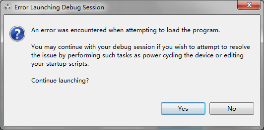

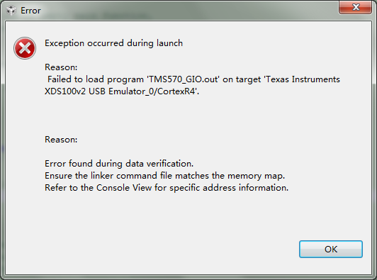

使用HalCoGen产生工程代码,使用CCS编译下载,build过程没有问题,debug之后出现:
在CCS的console中输出信息:
CortexR4: GEL Output:     Memory Map Setup for Flash @ Address 0x0CortexR4: Loader: One or more sections of your program falls into a memory region that is not writable.  These regions will not actually be written to the target.  Check your linker configuration and/or memory map.
CortexR4: File Loader: Data verification failed at address 0x00000002 Please verify target memory and memory map.
Error found during data verification.
Ensure the linker command file matches the memory map.

不过,同样的配置在TMDX570LS31USB (for USB Stick)出现的问题不同,输出信息如下;
CortexR4: GEL Output:     Memory Map Setup for Flash @ Address 0x0CortexR4: Flash operation timed out waiting for the algorithm to complete. Operation cancelled.
CortexR4: Trouble Writing Memory Block at 0x0 on Page 0 of Length 0x32d4
Cannot write to target
不知道问题出在了什么地方。求大神帮助!

       2. 配置问题的可能性
           但是看起来应该没有太大问题,除了cmd文件中RAM的长度应该是256KB,
           RAM     (RW) : origin=0x08001500 length=0x0003EB00

        谢谢你的回答!我按照你的提示,把CCS4.24卸载干净(附带的东西挺多的,下载起来还是比较麻烦的),手头上只有CCS5.2,就安装了。后来新建了CCS工程,修改了sys_link.cmd文件“RAM     (RW) : origin=0x08001500 length=0x0003EB00”,最后程序下载运行成功!
    Tkx!
