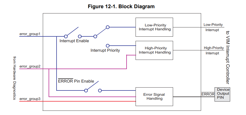

RM48Lx30相关手册中关于“parity protection for peripheral RAMs”中,如果检测到RAM有parity error,我们的CPU怎么处理读取到的错误数据?是丢弃掉重新读取?还是仍然使用?
. If any word fails the parity check, the module generates a parity error signal that is mapped to the Error Signaling Module. The module also captures the peripheral RAM address that caused the parity error.

12.1.2 Block Diagram
Group1 errors have a configurable interrupt response and configurable ERROR pin behavior. Note that the ESM Status Register 1 (ESMSR1) for error group1 gets updated, regardless of whether an ESM interrupt for that Group1 channel is enabled or not.

15.8.4 Fall-Back Address Parity Error Register (FBPARERR)
This register provides a fall-back address to the VIM if a parity error has occurred in the Interrupt Vector Table.
所以流程是这样的
VIM奇偶校验错误->设置了esm group1通道15状态(启用时)->执行vim奇偶校验处理程序。

Hello Susan,
你所说的这个流程我清楚了,那么我在处理程序中应该怎么处理parity error?TI有没有建议的处理方式?
另外,这个CPU的ECC故障ESM Group 3 channel 7 : Flash Uncorrectable error 有没有建议的处理方式?
