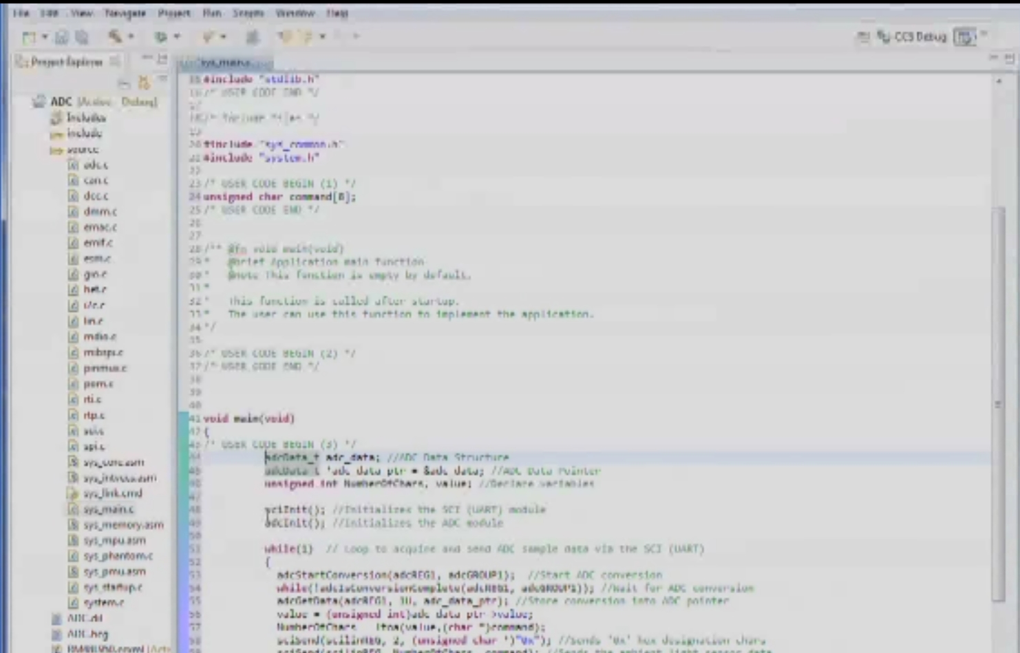

TMS570LS31HDK的video中的添加的代码是什么?ADC的
在TMS570LS31HDK的video中,关于视频HERCULES12-bitADC.wmv中的第08:30到09:32之间的粘贴的代码看不清楚,麻烦技术工程师帮助解答一下,或者写一下视频中补充的代码。谢谢
  • Hi Bill,
             您需要的代码如下所示:
    /* USER CODE BEGIN (0) */
    #include "sci.h"
    #include "adc.h"
    #include "stdlib.h"
    unsigned char command[8];
    /* USER CODE END */
    void main(void)
    {/* USER CODE BEGIN (3) */
      adcData_t adc_data; //ADC Data Structure
      adcData_t *adc_data_ptr = &adc_data; //ADC Data Pointer
      unsigned int NumberOfChars, value; //Declare variables
      sciInit(); //Initializes the SCI (UART) module
      adcInit(); //Initializes the ADC module
      while(1)  // Loop to acquire and send ADC sample data via the SCI (UART)
        adcStartConversion(adcREG1, 1U);  //Start ADC conversion
        while(!adcIsConversionComplete(adcREG1, 1U)); //Wait for ADC conversion
        adcGetData(adcREG1, 1U, adc_data_ptr); //Store conversion into ADC pointer
        value = (unsigned int)adc_data_ptr->value;
        NumberOfChars = ltoa(value,(char *)command);
        sciSend(scilinREG, 2, (unsigned char *)"0x"); //Sends '0x' hex designation chars
        sciSend(scilinREG, NumberOfChars, command); //Sends the ambient light sensor data
        sciSend(scilinREG, 2, (unsigned char *)"\r\n"); //Sends new line character
    /* USER CODE END */}
    有问题我们再交流,谢谢!
